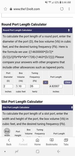

Okay so let's talk box porting for a second.... I have seen a lot of guys on different forums and a few videos on YouTube where they have used external porting on their enclosures.
Went to the 12 volt.com and punched in a few numbers accounting for sub displacement of my existing skar subwoofers into the round port calculator and this is what it shows....see attached
I have all three of my amps mounted to a rack on top of the box behind the seat but if I could make room on each side of the box for two 2" diameter round ports each 4.82" in length sticking straight up off of the top of the box with flared ends would that be an efficient way to Port the box or is my thinking off somewhere?

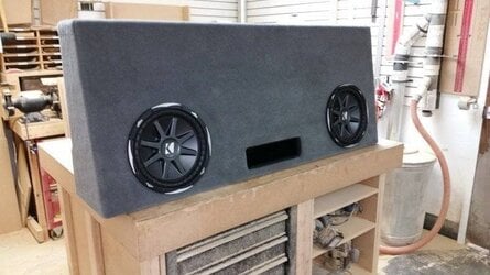

Well dam....I may have just answered my own question.  Just found this box online from a dealer and it is made for my truck!  I never saw this box when I was buying all of my equipment but I think it might be worth the swap.  I will have to sacrifice the reclining of my rear seats but I think I can deal with that.
The box specs are 5.15 cubic ft and the port can be customized to whatever tuning I desire apparently.
So my next question would be...what subs,  on what power, with what port tuning frequency would work best for what I'm wanting.
I don't want to be totally sacrifice the tight and accurate reproduction of fast bass notes and bass note distinction but I do want a more extended low end.
Cost not really being an issue what would give me the best of both worlds so to speak?
