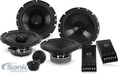

You will get a ton of input for speakers, I'll share what i like and what I've used/recommend.
For bright, articulate bass oriented hi-end "pop' these up front will do nicely and are about half price while they last @ $99 (usually around $199 to $249) The tweeter mounting is pretty straight forward too and is fairly easy to incorporate into existing OEM locations. I was able to mount them in my "A" pillars with a very little modification.
In the rear $199
- OR - $125
I have a set of these that are brand new that I upgraded the CAPs to 1% Dayton MPP precision caps for a build that didn't materialize that I will sell for $125 shipped.
That would put you at $375 to - $450 right there.
Add one of these to the rear area a steal at $69
in one of these @120
That sub/box combo would be hard to beat, lets stay with that for now. You could save a little on the comps/coaxial optnios too going with these instead.
$140 for front and rear N Series comps/coaxials
Well worth the $40 upgrade to the V Series front conmps/rear coax @ $180
Again, there are a lot of options that work. but these I've used, the NVX set up recently with a guy in here on his BMW M3 and he was really impressed with the outcome as well.

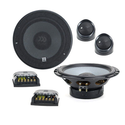

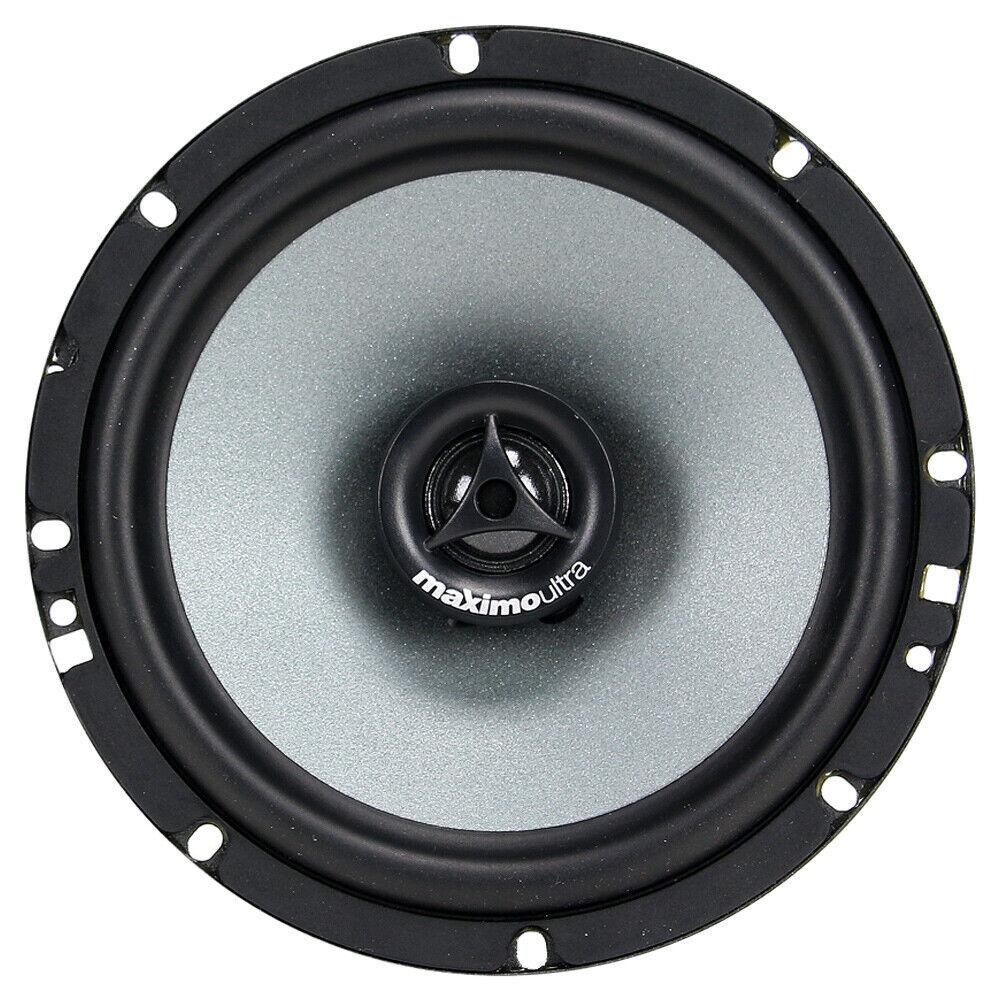

What about these for the front:
and these for the rear

For the Morel you linked, I can have them here for $295, that's $130 less than the USA.
Are they any good for their price?

Morel does not get much love here, I think people look at it like an old school brand that is not relevant today (I could be wrong!).
Ha, well then... I'll certainly take you money then! ;)
Morel are great speakers, especially the Accuflex coated tweeters and mids, a little spendy here but yeah, very good equipment.
The brand is thought of highly in the states (myself included) and around the globe (or so I thought) and those that get them are pretty faithful to the brand. I've used a number of their accuflex dome mids and dome mid/tweeter plates in home theater applications and really like them quite a lot. One of the best soft dome mids/tweeters on the market in my option. The Piccolos are par excellence and not one you ever hear anyone sing anything but praise about here or any of the other forums I visit.
For what we pay on them here, there are other products in the sub $500 a pair that compete favorably for the same or less money.
Like these sets for $499
paired with these coaxials $399
If I could afford the Morel hybrids or Elate Carbon series, I'd get them in a heartbeat! We pay a premium for them here and that often pits them up against other fanatic domestic US/Canadian brands and then it's gets very subjective. Brands like Stereo Integrity Stevens and CDT to name a few.
The Hybrids and Elate Carbon are super expensive here too haha ... Just checked the price in the US, they are still 60% cheaper here.
I think I'll bite the bullet and go with the Morels, it says on their website that they can even work well on stock headunit, should I give it a try before going with amp or just put them with the amp straight out of the box?
I can even afford the "higher" tier Morel Tempo Ultra 602 MKII (Only $220 for components without rears, they are almost $500 at Cruthfield) but it looks like they don't have coax version of them for rears.

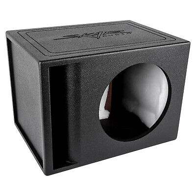

And what if I don't go with subwoofer, will I miss out on low bass?
