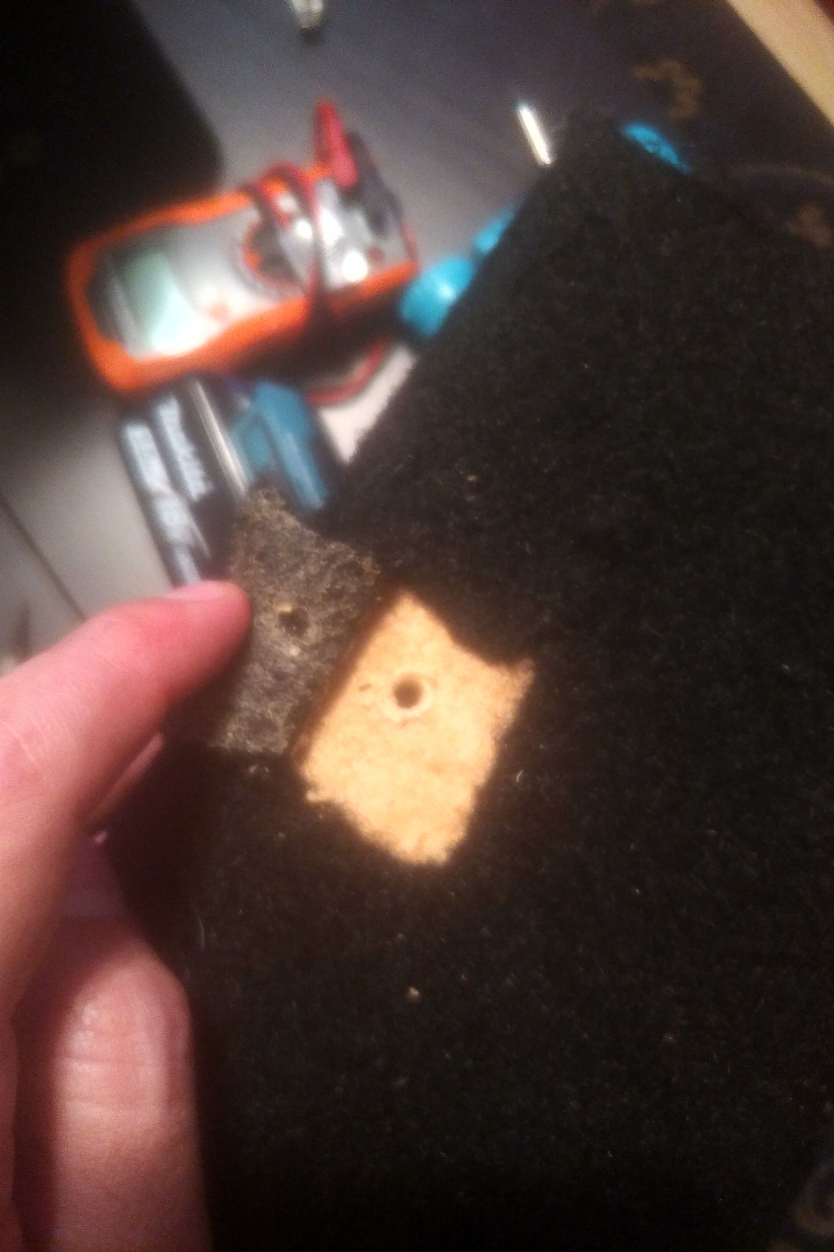

Lol found one of the sources of air I was hearing, looks like they were running a custom port mod on the JL wedge. Might stick one of those metal straws in it and try to get it tuned a bit lower :ROFLMAO:
Also found one of them had the terminals broken off inside so it's a nice ghetto home soldering job on the jumpers. Still sounded fine on a quick test minus the air noise & reads right at 2ohms on the meter can't get individual readings unless I break out the soldering iron. The one that still has the push terminals read just over 4 on both voice coils
