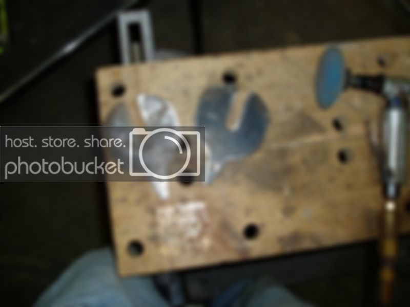

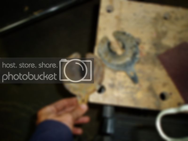

Before
After

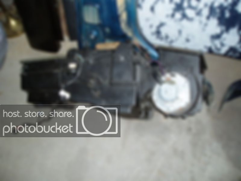

Heater core fixed up and ready to be put back in
