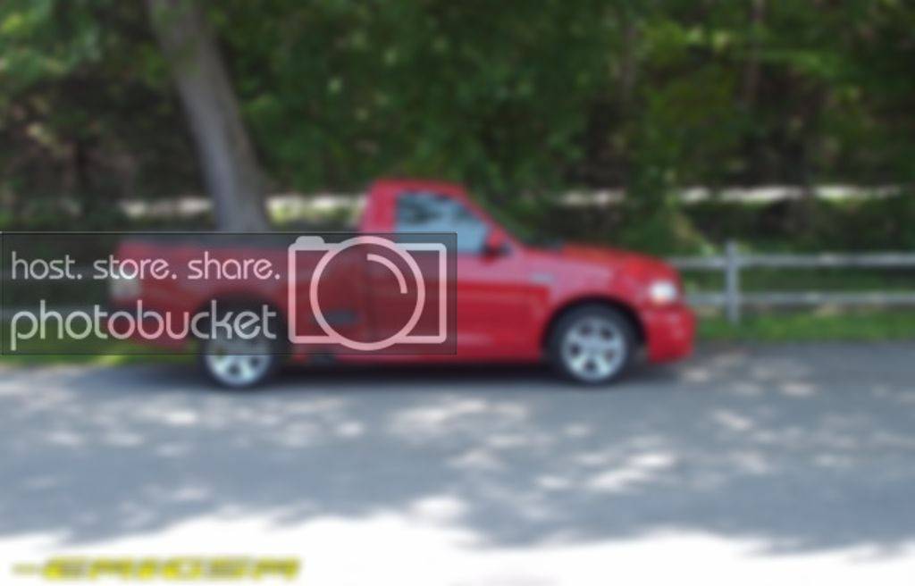

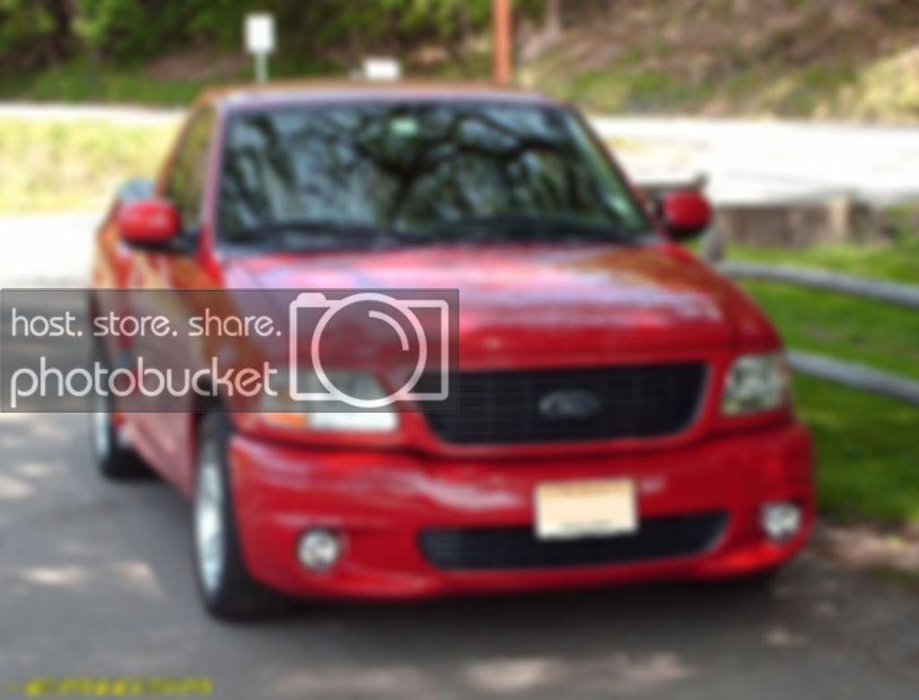

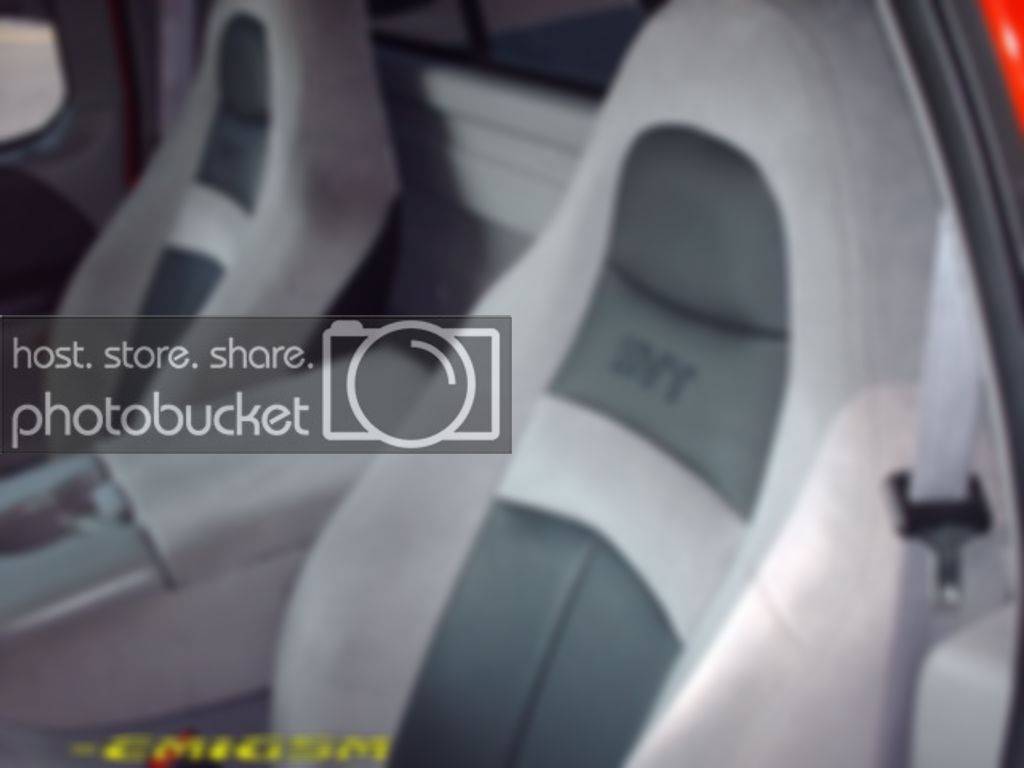

Pics of truck or GTFO lol
Oh ok, lol....
Build #39 of the 04's.... //content.invisioncic.com/y282845/emoticons/wink.gif.608e3ea05f1a9f98611af0861652f8fb.gif
