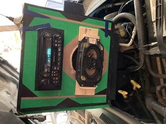

And the RCA cables ? Using a splitter with the two power supply slit in two will mean 12 volts + 12 volts. Maximum input no more than double the input or it shuts down. And that watts max being? Another point to make is for the amplifier to work properly the ground wire must be placed on. Reason is the negative supply volts to the amplifier is from that ground. Differential inputs. What r doing? Who cares about ur dumbs (thumbs) up or down? (n)(n)(n) This is a fact.
And another thing these setups are easy. It’s small potato like you that make car audio harder than it is. Because ur stupider. What do u say to that?
One more point than I’m done. OP AMPS, these mosfets or diodes looking creatures are the amplifies. They switch or amplify. Setting up an amplifier requires technical knowledge. + and - terminals. You do not hook up an amplifier because you think it will give more power. Conservation of energy in physics applies. It is merely transferred From one unit or quantity to another. Using mosfets.
These have mosfets. I made it. Technical knowledge is this.​
