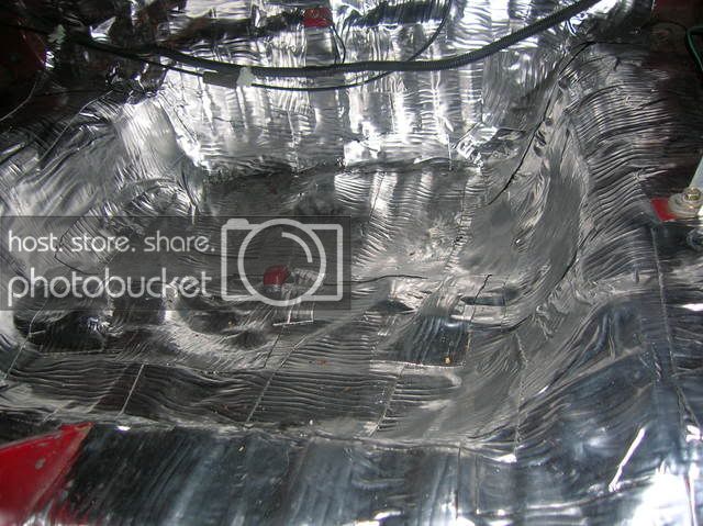

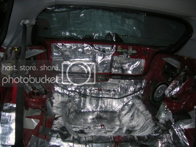

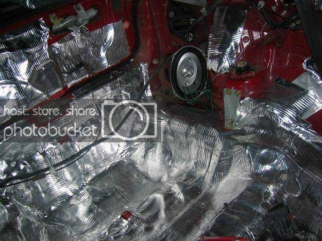

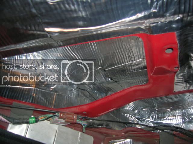

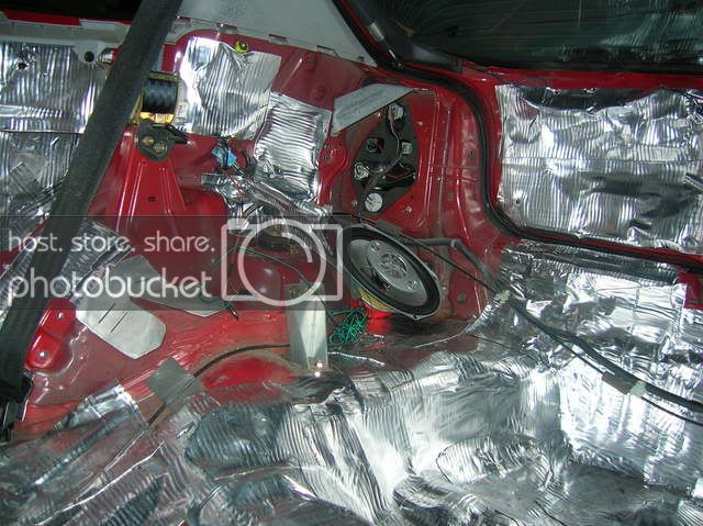

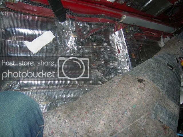

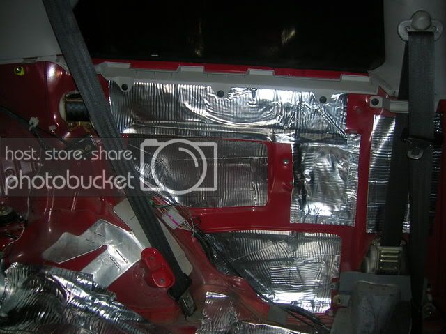

and to get more room idk how I'd do it, i have this lump that comes up for the rear seat to bolt thru in the middle. youll see it in the pictures of my sound deadened car //content.invisioncic.com/y282845/emoticons/smile.gif.1ebc41e1811405b213edfc4622c41e27.gif...

^^^lump is right there right at the edge of the left side
Im thinking of maybe mounting a battery where the spare tire goes?? or maybe the amp?
What kind of deadener is that?
You could always cut that hump off where the spare would be bolted to, but...or...you could just build your box with a lip that would sit on top of it.

also, i wasnt talking about the spare tire hump, i was talking about the rear seat bracket. its visible in the bottom left of the picture. I dont wnat to cut it off, because if i ever sell my car, what do i do

and also the deadener was peel and seal. it was used to drain out some of the sound from my exhaust
how do i make it 4.5 @38 and make it over that hump that the rear seat bracket in the middle of the floor is....not the hump in the hatch/spare tire area...

but thats not 4.5. so i gotta find a way to get around that bracket
