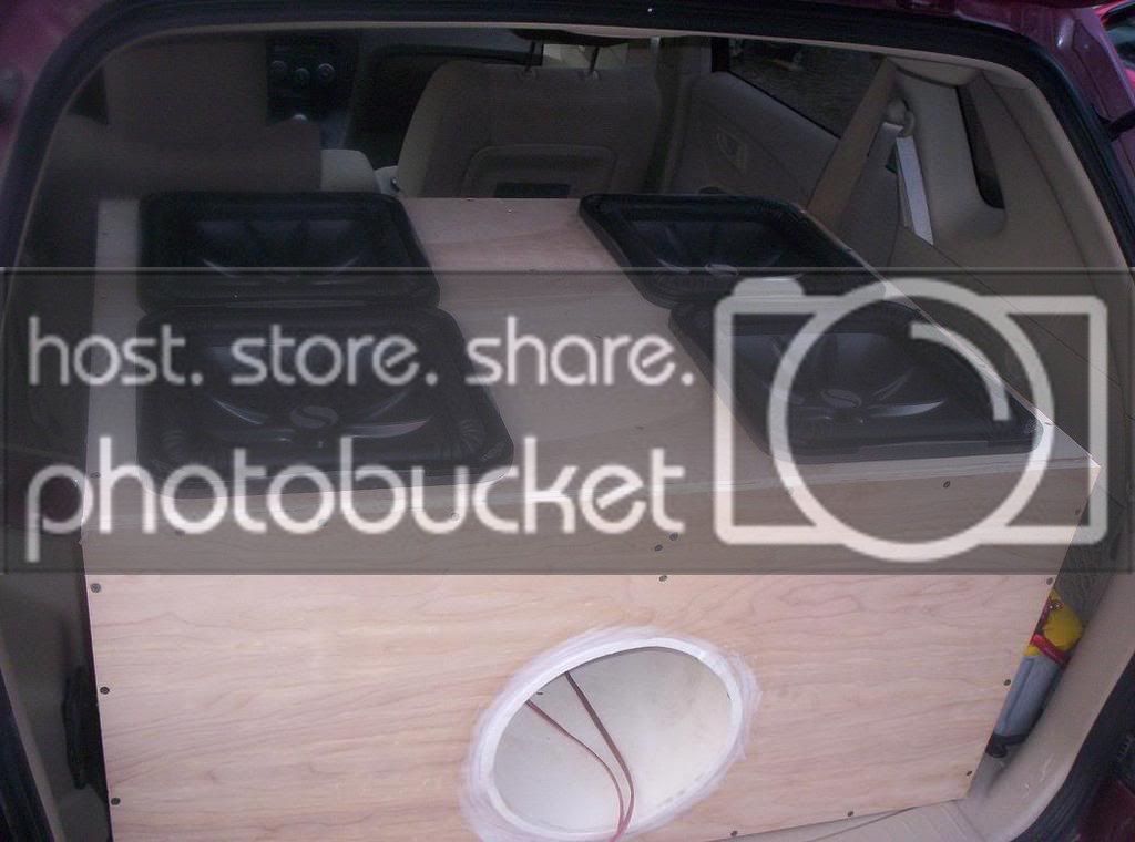

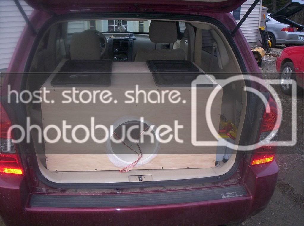

and this is the same port in another vehicle
my buddy built it so its sloppy as all shit
we dont know yet, my buddy blew his MA 4000D before we metered it and I had to pull out the JBL he was using to send to DB_DRAG_SPL for my new Wii //content.invisioncic.com/y282845/emoticons/smile.gif.1ebc41e1811405b213edfc4622c41e27.gif so now I have two PA A3000D's coming for him. He is going to go to the show this saturday in Mass I think, so I'll know then.

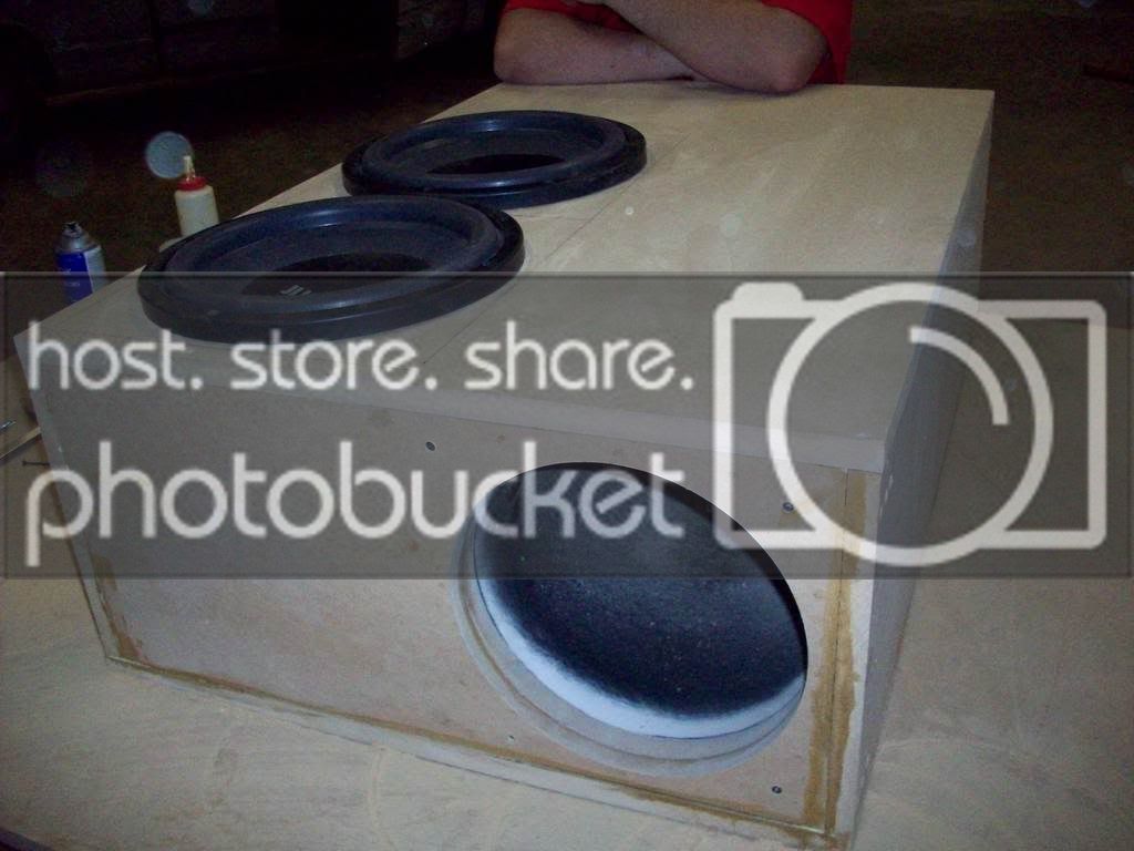

how big is that freaking port? where would you get something that big? Thats perfect for my setup, I gonna port 4 15's in 14 cubes, need about 240sq/in of port and only have about 20" depth to give up......
That box is a beast, complete double baffle...... wow
Where do you get such a huge port? I dont have ALOT of depth to give up, maybe 20" tops, and I need alot of sq /in of port to let 4 15's breathe....

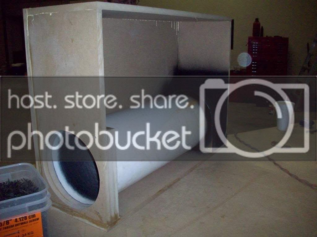

If you only have 20" of depth, you won't be able to run that big of a port. The larger the port, the longer it has to be to get the same tuning
Im quite surprised that it wasnt flared, especially with that double baffle. Just get a nice large roundover bit, im sure even that would help.
i did. i just did not take pictures of the finished enclosure.
i will early next week.//content.invisioncic.com/y282845/emoticons/biggrin.gif.d71a5d36fcbab170f2364c9f2e3946cb.gif
it is accualy tripple baffle just for that reason.
ok now where did you get pvc that big? or would one of those round concrete forms work too?
model rocket builders use cardboard as an inner form then after the carbon fiber sets up the cardboard it soaked in water and peeled out. I think the same technique would work nice for custom ports. I might try it out.
