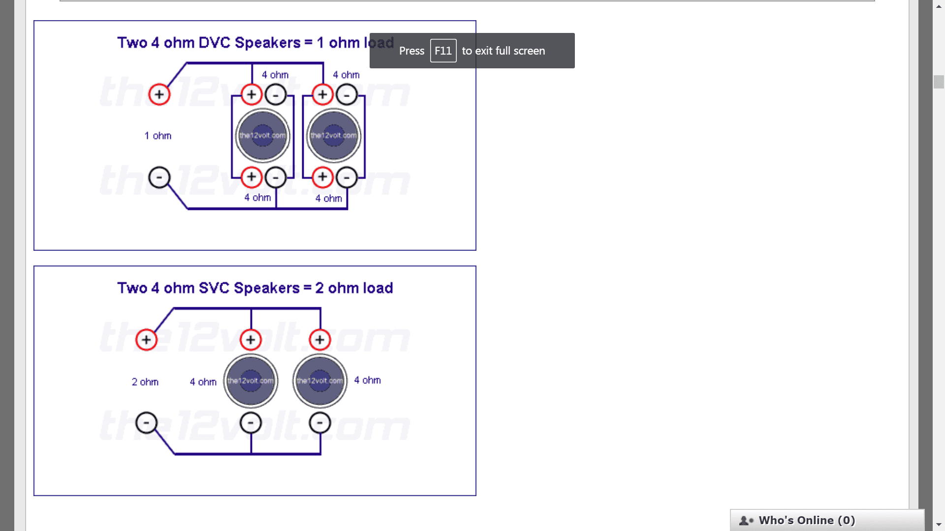

Those help too. I'm guessing I need to do the top one to get the 1ohm impedance for the amp you suggested. Thanks for that. Now that that is decided. Just need to configure a box for the 12's in my Pathfinder that will eventually go into my Subaru and a configuration for the 10's to go into the Pathfinder when I switch my 12's to the Subaru.

Hmm...I guess the question now is to figure out which is which and figure the correct way to wire them.

if they had 2 + and 2 - on them it's dvc. if so u could get that skar if they only have 1 + &1- that'll be 2ohm load and u can get my ppi p1k which tested at 930 rms at 2 ohm plenty of power.. yeah if i say something about someone sytem and they have 4 10's instead of 2 they get mad..
