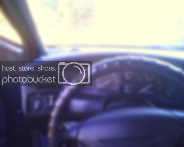

did not read whole thread //content.invisioncic.com/y282845/emoticons/fyi.gif.9f1f679348da7204ce960cfc74bca8e0.gif
i had mine like this, sounded good to me, but i'm no SQ guy...
old pics:
