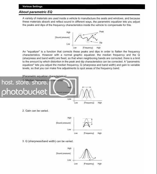

Here are some pages regarding frequencies I took out of my Eclipse manual that me be of some help to you.
