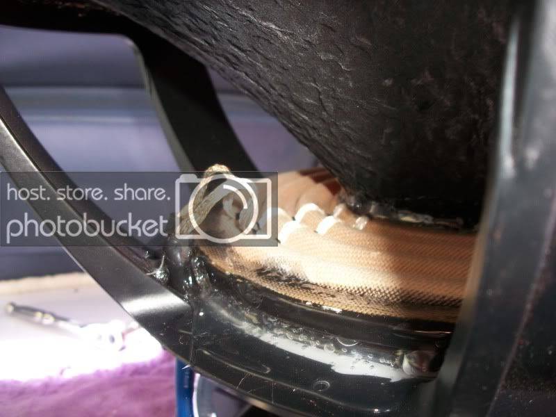

YouTube - Adding Epoxy to SA-8 Spider Landing
Decided to make a video since so many people want to use these in SPL burp applications and high power (50%+ over rated power) and large enclosure (25-100% larger than suggested) applications.
For these applications you will want to run a bead of epoxy around the spider as shown in the video.
Has worked great for me... have done around 100 burps at over 1kw per driver in my CRX this way... hitting 153 dB.
The next run and forward will simply feature a bolted down spider to handle all applications right off the bat.

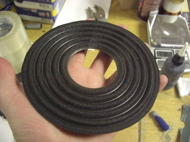

Here is a good photo of the spider :
ahh i thought for sure it was a 6" spider being used on that sub,hmmm
This particular spider allows alot of throw -- has pretty tall rolls on it. It easily allows more throw than the 16mm linear one-way of the motor -- spider allows at least 20mm one-way.
