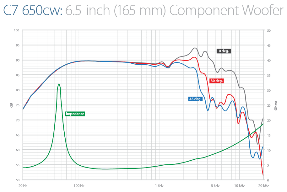

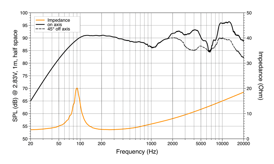

To this other point, here's an example of the frequency response of a Hertz 165.3.
Hertz lists this as 45-21.5k frequency response. Kicker doesn't offer a frequency response graph, but each manufacturer does it differently.
Here's a JL audio 6.5 speaker which lists the range as 50-5k. It's not an exact comparison, but we're only interested in the low end. You can see that even the standards of what db qualifies as a response between brands are different and these two brands are some of the best performers throughout these ranges. I take this to mean that Kicker is likely overrating their range, but it doesn't matter because each brand does it differently. It's more of a rule of thumb to compare speakers of the same manufacturer in my opinion.
