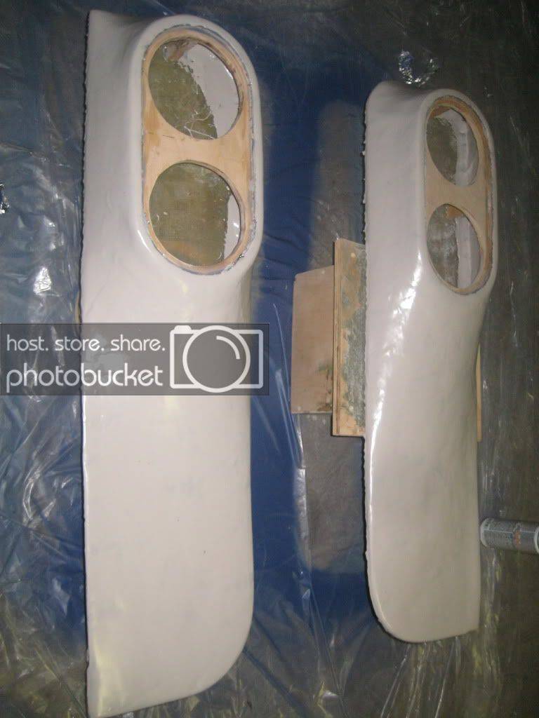

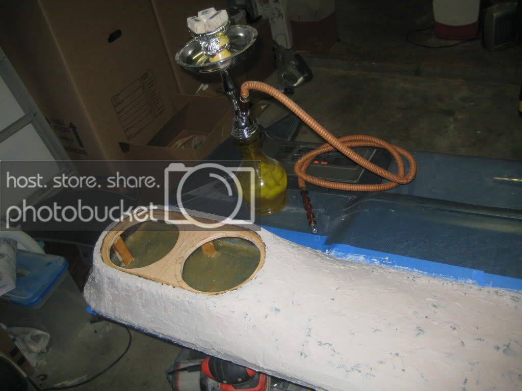

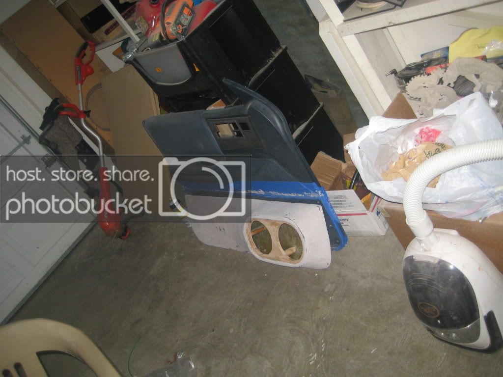

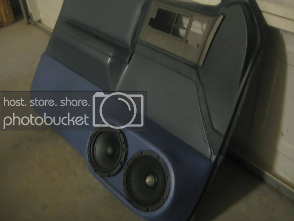

what i did was take about a sand dollar size of body filler and about a dime size or so of the red hardener and mix it up real good...pick up one of those bondo plastic spreaders which are real cheap and apply real thin coats of it.....the smoother you do it the less sanding you have to do....then if you want, make another batch and add 2-4 ounces of resin and hardener, mix it up to make up some milkshake and pour it on or use a paint brush or sponge and make it real smooth and will fill in all the little holes and imperfections.
I did this to my door pods.
body filler before sanding (and a couple puffs taken from hookah) //content.invisioncic.com/y282845/emoticons/tongue.gif.6130eb82179565f6db8d26d6001dcd24.gif:
sanded down:
then some milkshake:
then some paint...and wala: //content.invisioncic.com/y282845/emoticons/tongue.gif.6130eb82179565f6db8d26d6001dcd24.gif
**** that looks good!!!! ^^^^....thanks so much for everyone replys....will let ya'll know if i need anymore help //content.invisioncic.com/y282845/emoticons/smile.gif.1ebc41e1811405b213edfc4622c41e27.gif
