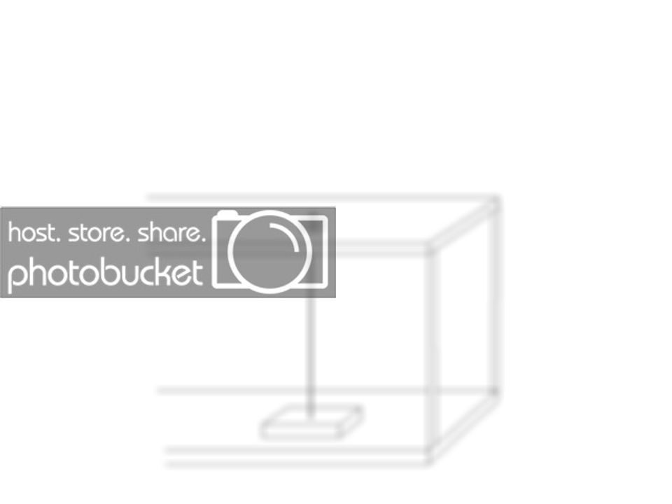

You can "flush mount" the threaded rod.
Drill a hole in the top and bottom of the box big enough for the washer and to fit something in big enough to tighten down the nuts and washers.
Cut out two 4" by 4" pieces of MDF to glue and screw inside of the box (top and bottom). Drill holes just big enough for the threaded rod to go through.
You will actually be mounting the threaded rod to the small squares of MDF on the inside of the box. This way you can cut off the threaded rod flush with the actual top and bottom of the box.
heres a pic of what im talking about:
thanks for all the ideas guys. gunna run past home depot tomorrow and pick up some things. ill post pics once its all done for those of you that want to see it.
