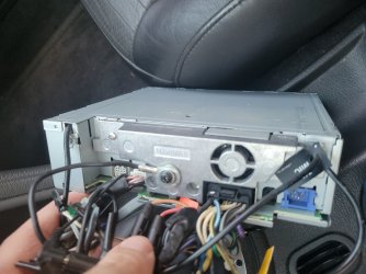

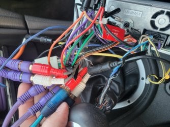

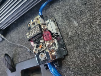

Thank you all for taking the time to reply. I've been tearing down the system/wiring trying to isolate the problem. Please take a moment to look at my attachments and recent findings:
1. distribution block lost it's ability to show the voltage, perhaps some clue or maybe irrelevant. Fuses are not broken and it is grounded. Amp powers on fine.
2. deck has rca wire to wire connection, not rca wires to rca jacks on deck, (didn't try the pico workaround)
3. videos show popping sound when going from volume level 0 to 1 and 1 to 0, also and when changing radio stations (in accessory mode) Also when turning on / off the car
4. no popping sounds when increasing volume or leaving radio playing (in accessory mode)
5. I tried using each set of RCA cables on the rear speakers alone, then the front speakers alone. The popping continued in each scenario. (accessory mode)
6. I removed each speaker wire from the amp, one by one, the popping continued.
7. With the car started, the whine is constant, with the car in accessory mode, the whine is not present.
8. When using the power windows, the whine is presented loudest. When accelerating, the whine increases.
Can anyone make sense of this or help guide me to next steps to troubleshoot further
