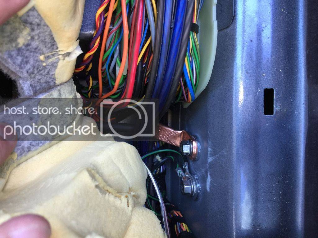

I'm going to hook up the tweeters directly to my factory amp and see what happens while I'm there I'll upgrade the factory amp's ground.
I will move the grounds in the trunk again but I don't know to where now. I tested the resistance with a DMM and got 0.0 from my battery terminal to my grounding spots. Is there another way of testing grounds? I also have a 1/0 run from my negative terminal to the trunk. Could the battery be the cause? It's Duralast.

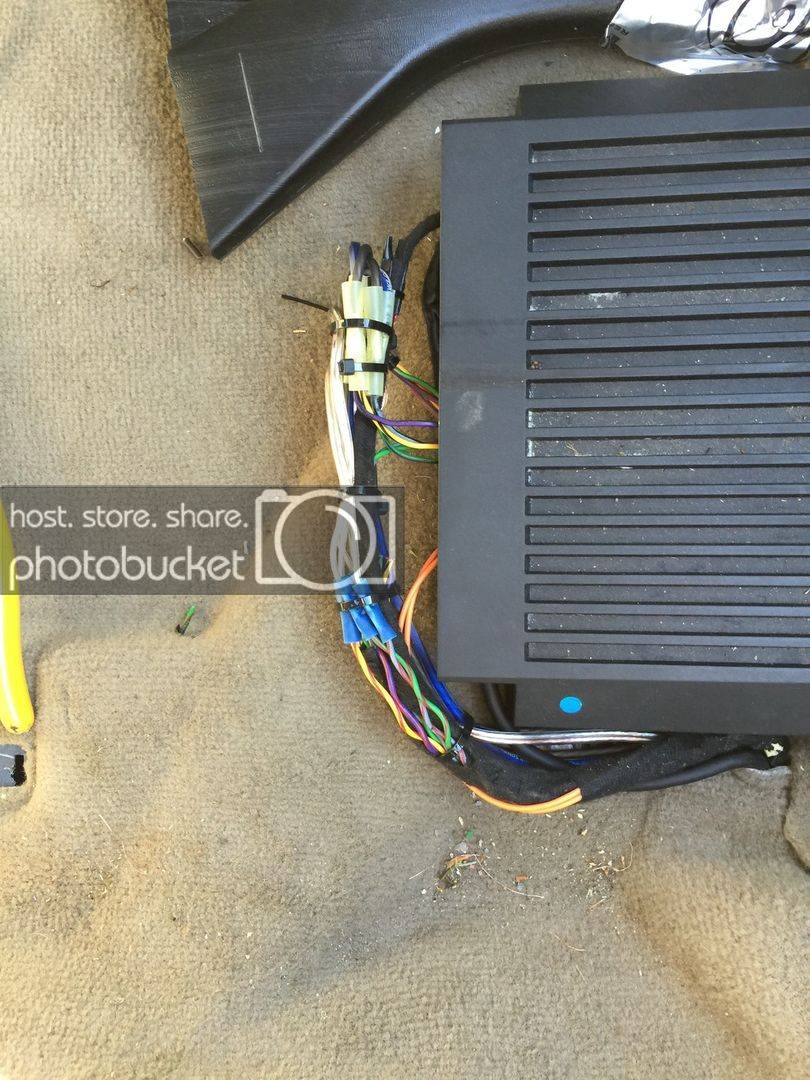

I upgraded the ground to my factory amp and also cleaned up the splices and neatened it all up.

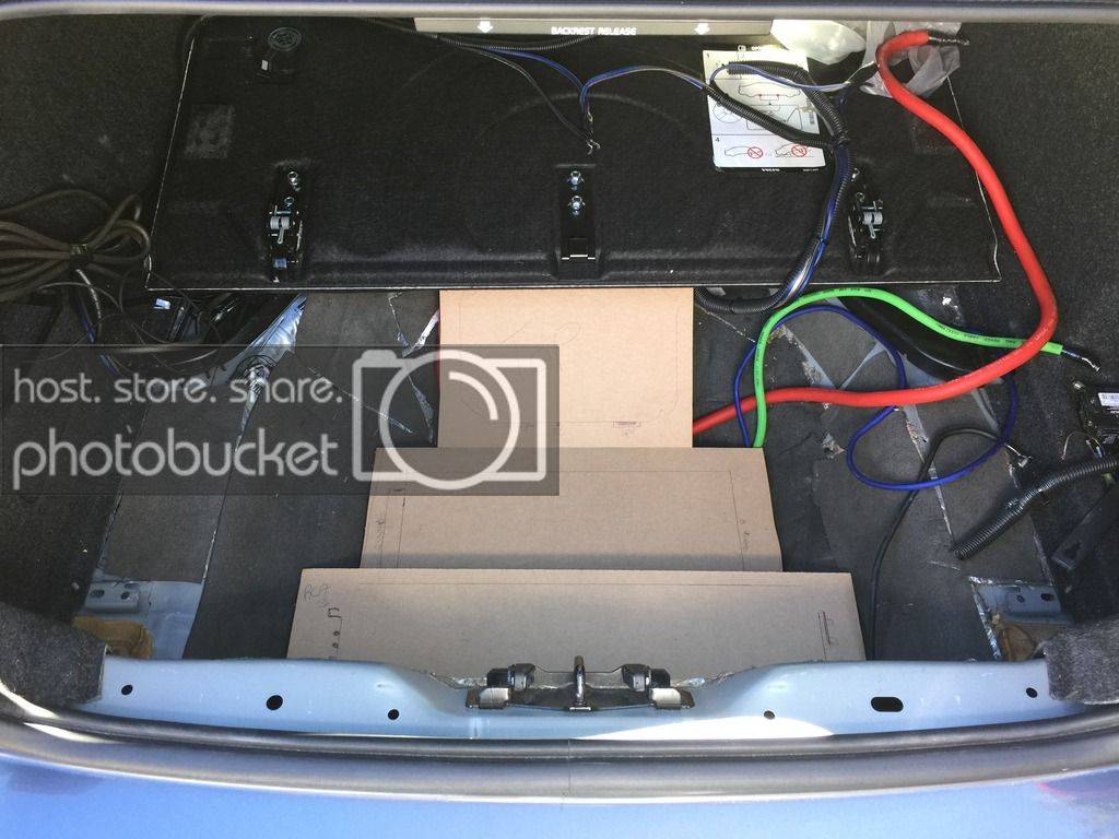

For now I will move on to building an amp rack. I haven't had the zed in my trunk for a couple months so it's time to get on with it.
Here's my current idea on amp positioning I'm going with sanded plywood and I'm going to stain it black or grey.
