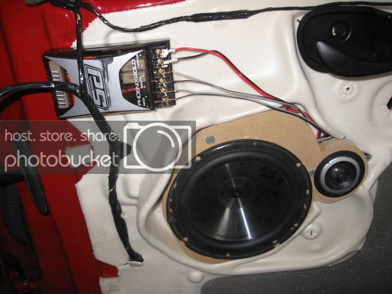

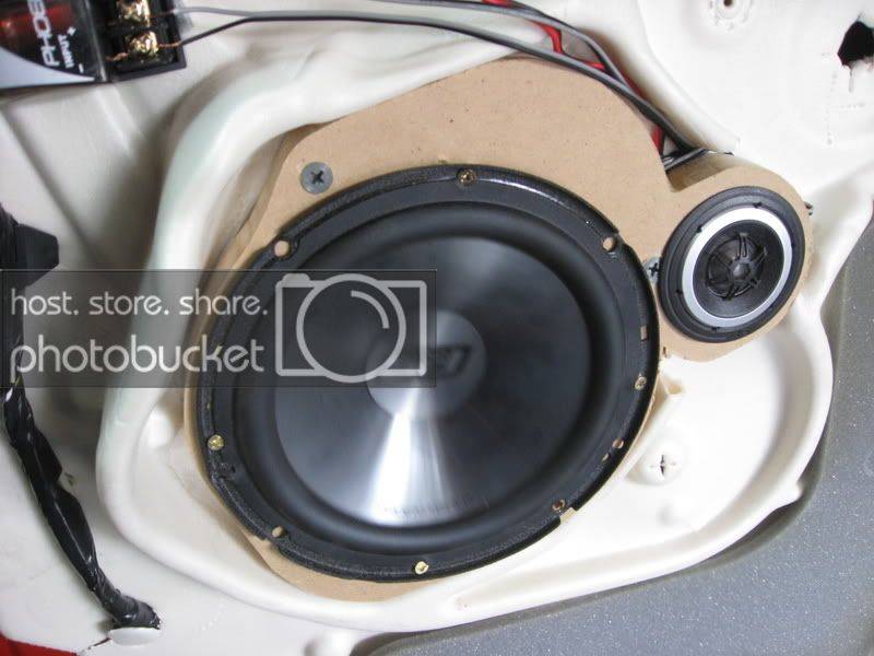

Also: Got my RSD's in.

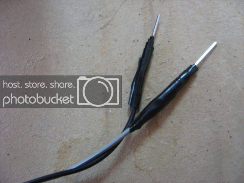

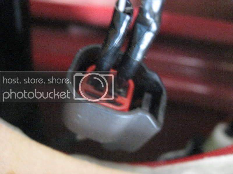

Not cutting the factory wires ftw. I just got a paper clip, cut off two pieces, and wrapped the wire around it and taped it on. Plugs right into the factory harness.
