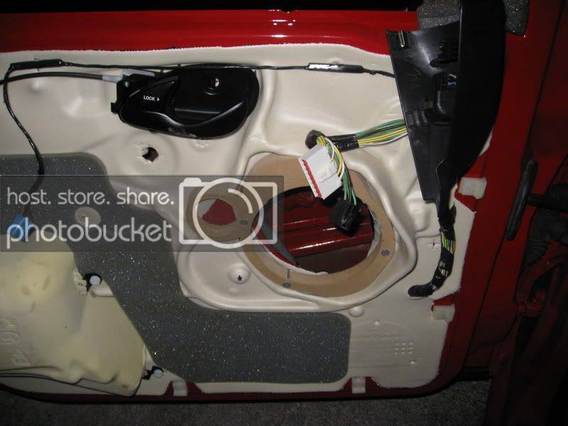

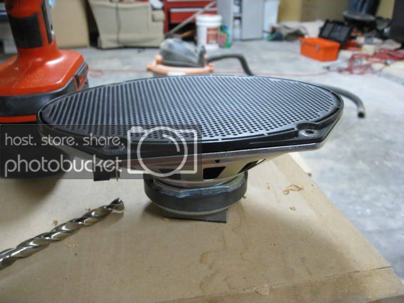

I just got an 07 ZX4, and the factory speakers are a joke.
mmmmmm BEEFY!

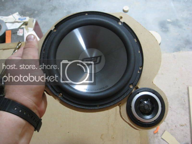

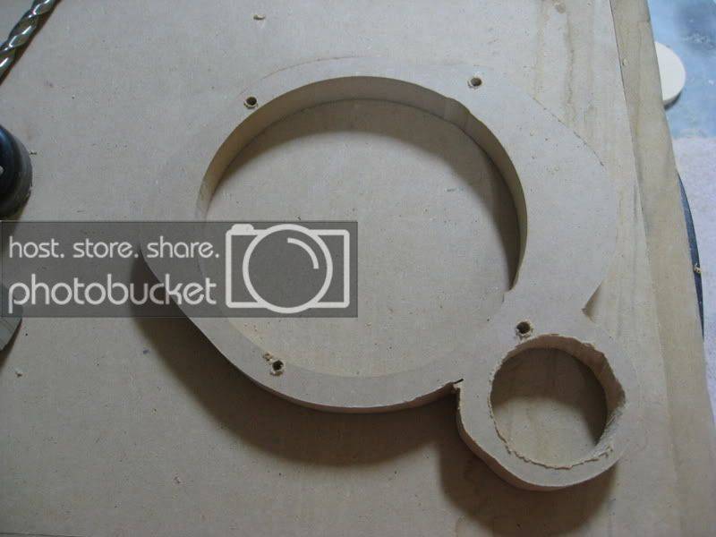

It's a 3/4" MDF spacer that adapts 5"x7" to 6.5" and has a little side-pod for a tweeter. I decided to use some Phoenix Gold RSDs because I had them sitting in the closet, and I'm too broke to get any other new speakers.
All the modification it takes is cutting a little bit of foam to accomodate the tweeter, seen here:
