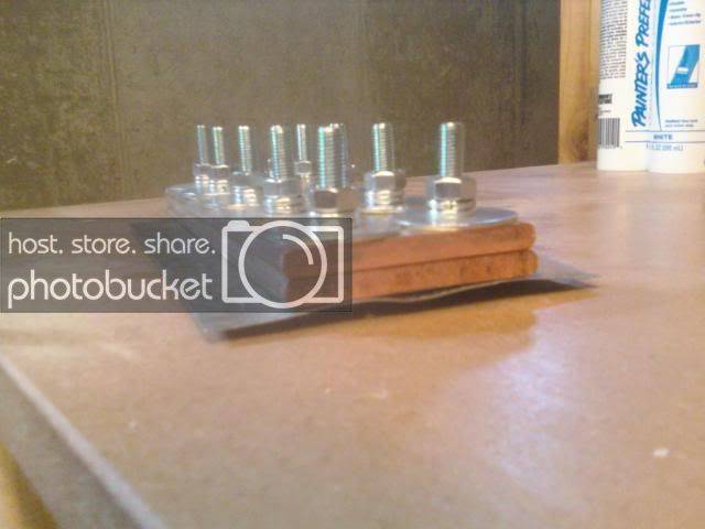

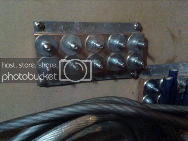

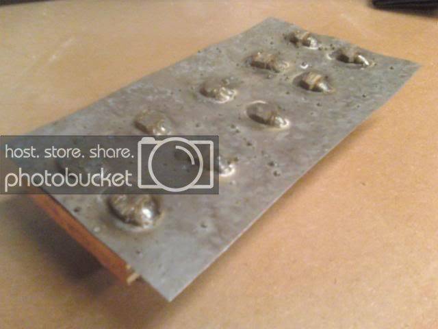

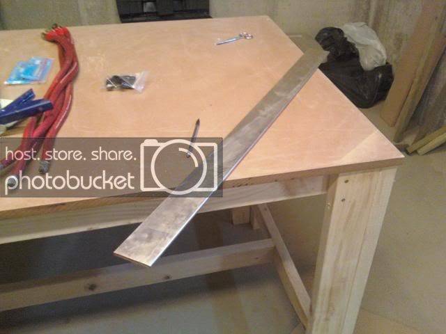

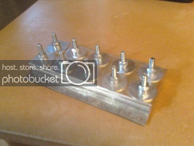

They are relatively simple to make with a drill press and a band saw. It started as a 2.5'' x .25'' x 36'' silver plated copper bar. The reason for the welds is so that the bolts do not turn. It is designed to comfortably join 20 runs of 1/0 gauge wire together. Because so much pressure can be applied to the wire from the copper through the bolts this design works very well for high conductivity.

you could have used brass bar and brass or stainless bolts. Or you could have used aluminum studs and threaded the bottom peice and TIG welded the studs //content.invisioncic.com/y282845/emoticons/smile.gif.1ebc41e1811405b213edfc4622c41e27.gif
