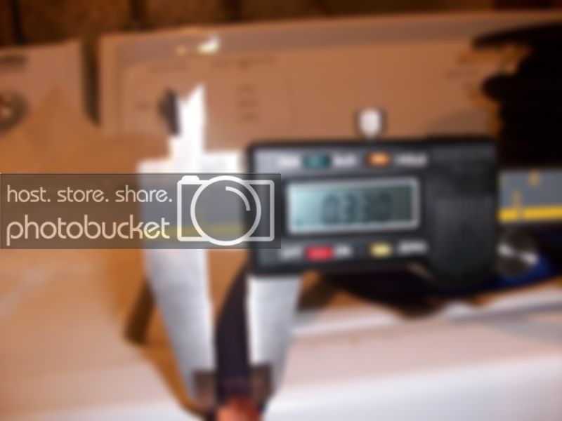

you clearly do no know what 0 gauge is actually suppose to be. true 0 gauge conductor size is suppose to be .32". the wire in that kit is rated at 250 amps. you like so many other tools do not know what you are talking about and just say what you heard other people say. Knu Fleks and Kicker Hyperflex as well as RF all use oversized 0 gauge wire to make clowns like you think that paying 2-3 times the price for a minimal increase in current.

Ya I do know what true 1/0 should look like and this stuff is not true 1/0 it's not even close. I don't run knu, kicker, stinger or rf wire. I run 2/0 and 4/0 full copper welding cable

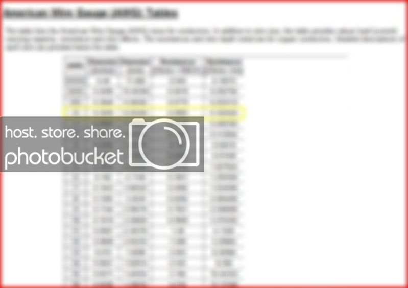

The chart posted is for solid cable, not stranded. Solid 0 gauge has a OD of 8.251mm(.3248") and stranded is ~9.530mm(.3751") roughly 15% difference. In any event gauge is determined by area of the conductor, not diameter because a stranded cable that uses large gauge strands will appear smaller then that of a cable with many finer strands. This is due to the air gaps (displacement) within the cable no matter how tightly twisted the rope lay is
