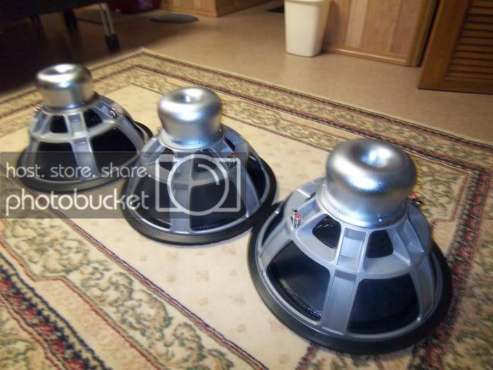

(3) 18" TC Sounds Pro 5100 Neo Subwoofer Drivers

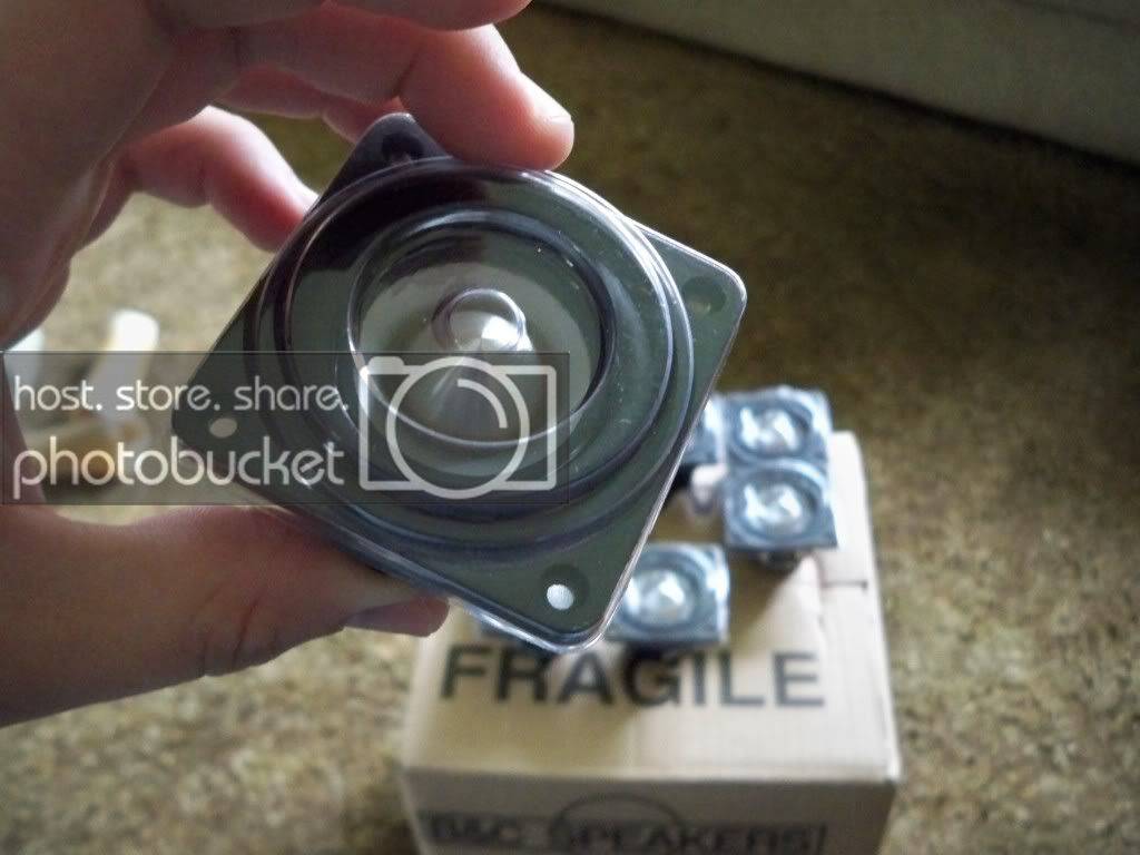

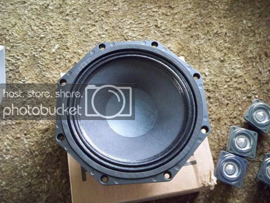

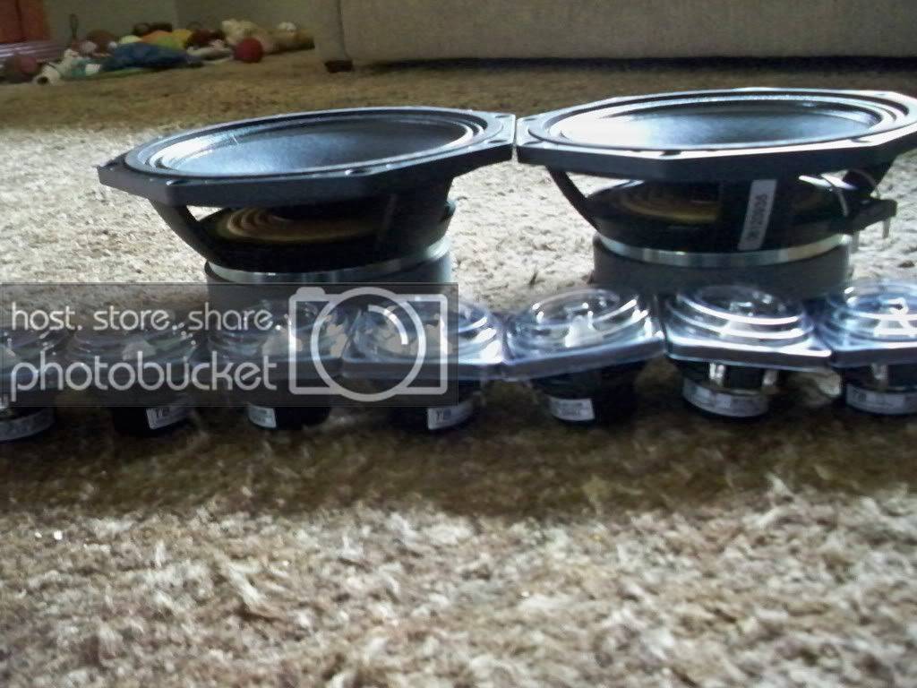

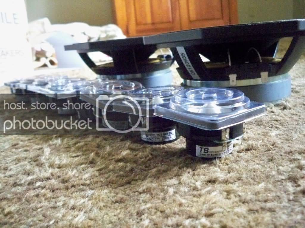

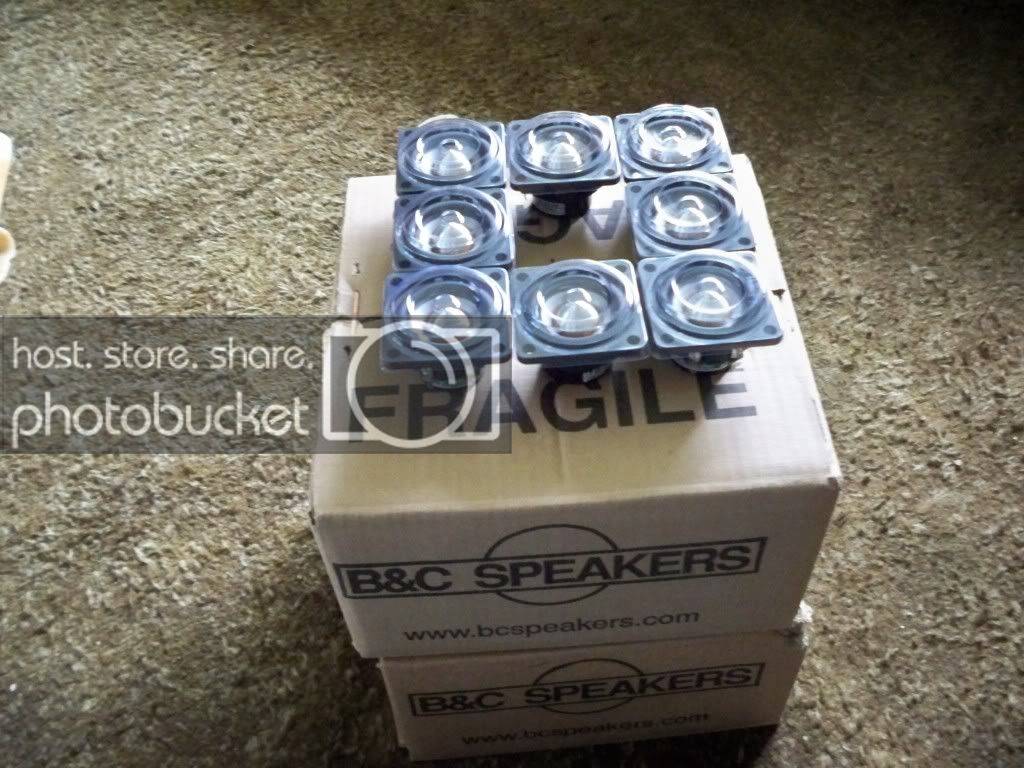

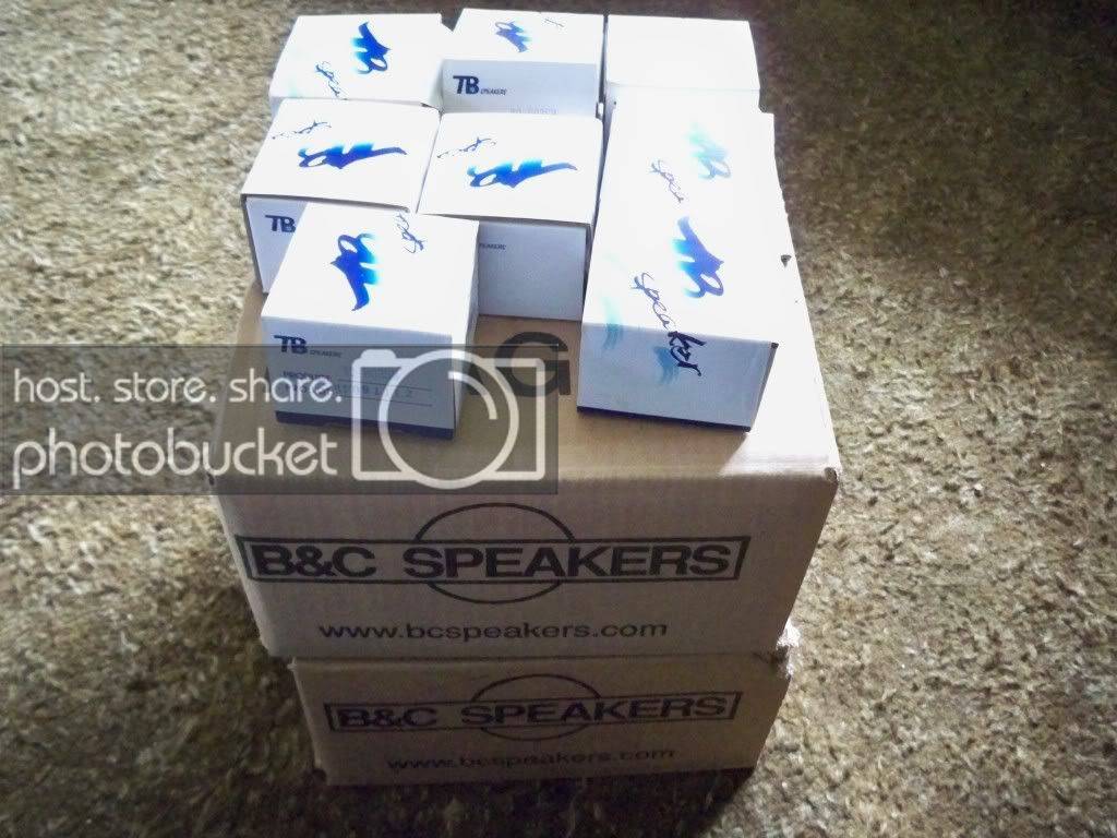

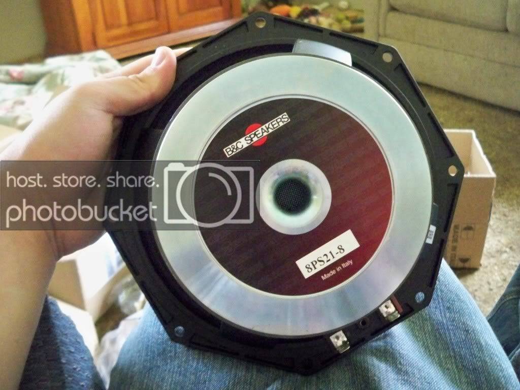

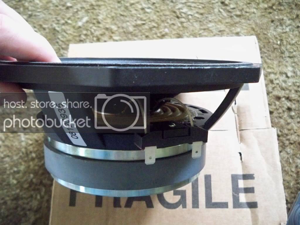

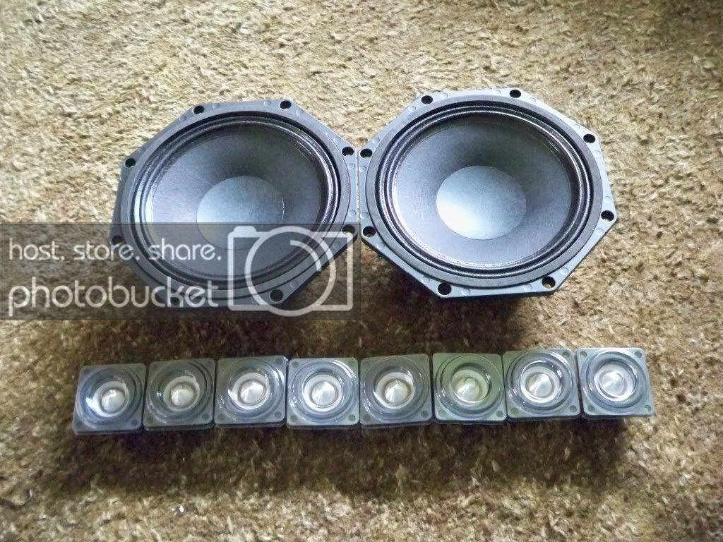

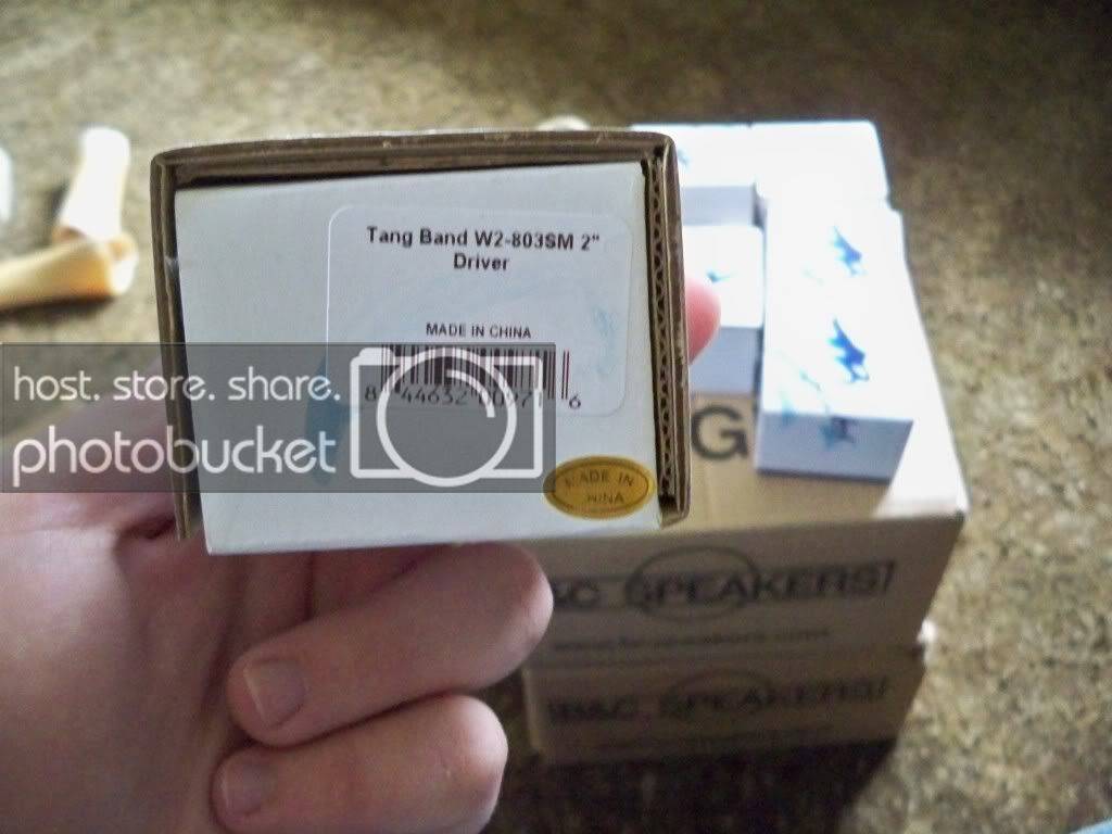

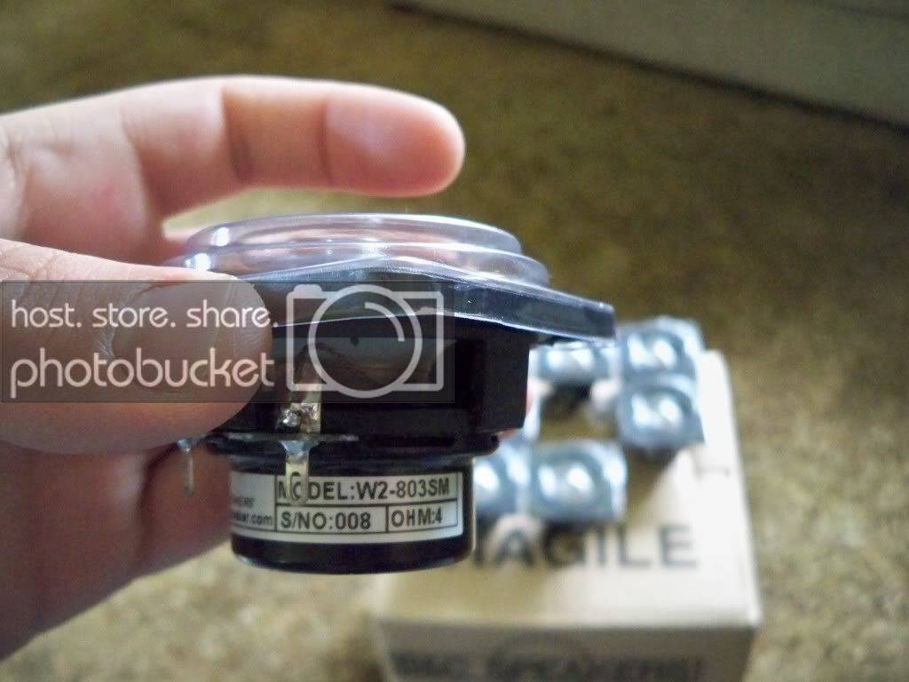

Ok guys here are some pics of the front stage that is going in the car.
Each A Pillar will have (4) 2" Tang Bands.
Each door will have (1) 8" B&C Midbass driver and 2 O2 Audio 6.5" speakers

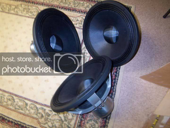

specs on the subs
Specifications: • Power handling: 1,000 watts RMS/4,000 watts peak • VCdia: 4" • Le: 2.8 mH • Impedance: 2 ohms per coil x 2 • Re: 3.02 ohms • Frequency range: 15 - 150 Hz • Fs: 26.5 Hz • SPL: 94.5 dB • Vas: 8.88 cu. ft. • Qms: 6.90 • Qes: 0.25 • Qts: 0.25 • Xmax: 31.0 • Dimensions: Overall diameter 18.52", Cutout diameter 16.83", Depth 11.27" • Weight: 53.4 lbs. Note: All specifications are with voice coils connected in series.
High-temperature low eddy-current stainless steel voicecoil former
2+2 ohm dual voicecoil 4-layer flatwound Aluminum wire, 4" diameter voicecoil
10" linear dual spider suspension with large integral lead-wires
3" long segmented radial NdFeB motor assembly, for low mass and very high BL
FEA designed 3-roll cloth surround for greater than 2.5" peak-to-peak travel
Field-replaceable top assembly system
Large anti-flux-modulation shorting ring
Sandwich acrylic foam fiberglass cone
