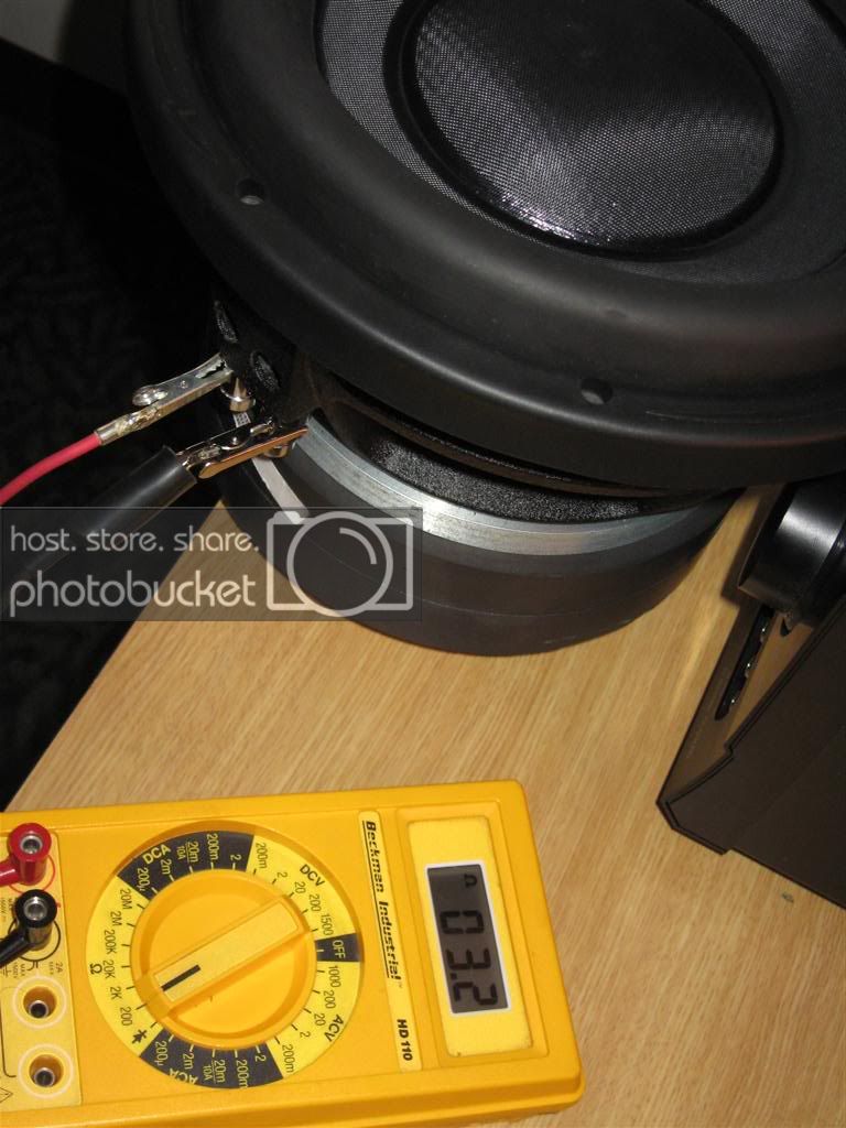

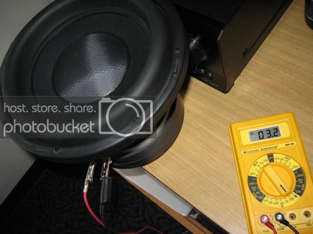

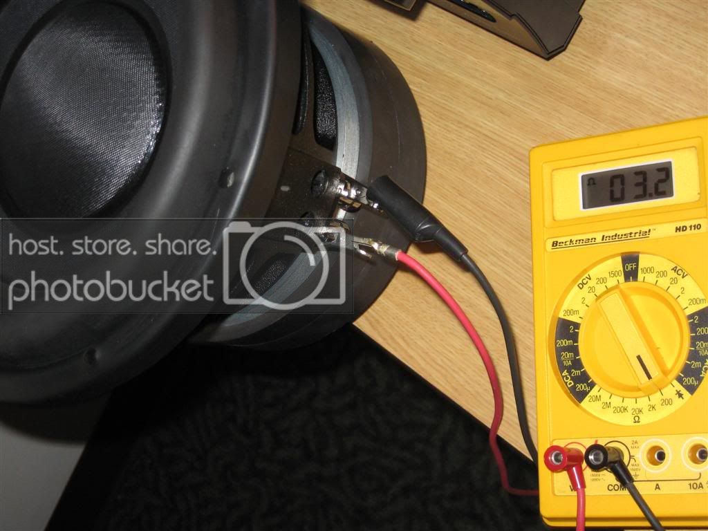

Got bored and measured the coils but only took 3 out of 4 pictures of the 4 coils for some reason (next to the onkyo for any HT fans out there). Trying to find excuses to use my new camera now.
