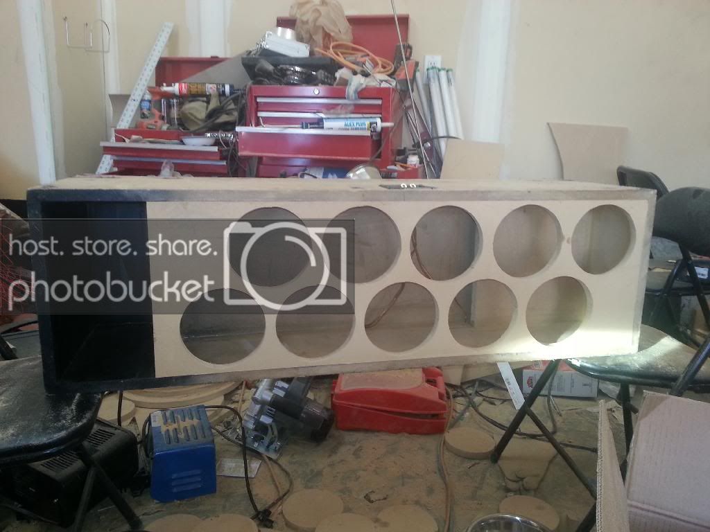

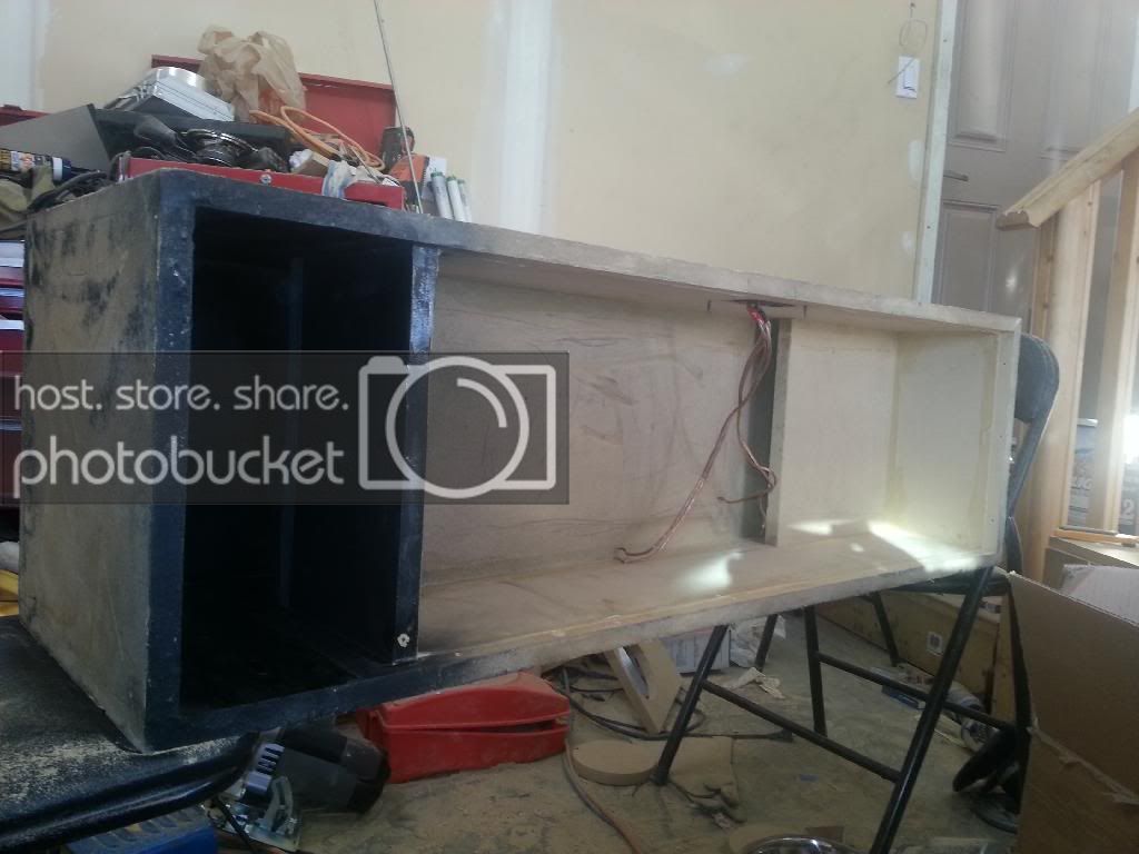

So it was time to get to wood working, I had a ton of boxes going through my head but was limited with space because of the street stock rules. Ended up building a transmission line with a 5 foot long port, then decided to alter the port so it has a tapered flare/horn port over the whole 5 ft of length. The port starts at 24sq" and flares out to 100sq"
So I'm running the amp at 0.8 ohms by running 5 woofers parallel and the coils series and the same for the other 5 woofers, then parallel both together. If any one is.lost with that,... Its to many series parallel and parallel again coils to.explain.. I'll try and get a diagram made for you just pm.

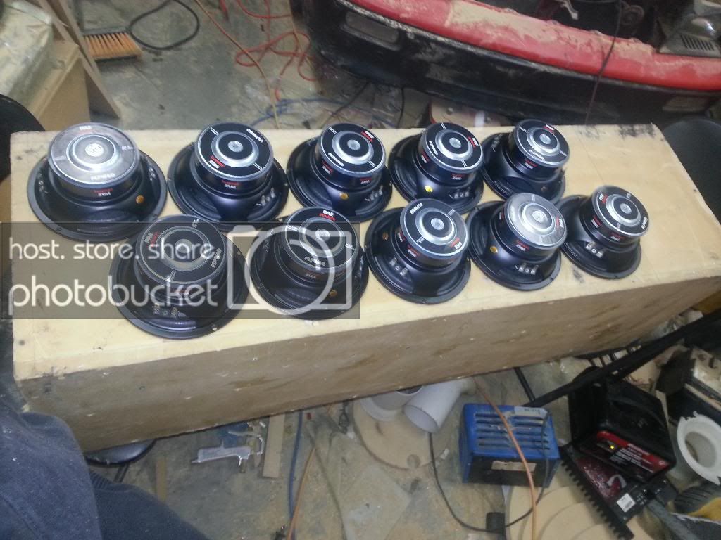

So the door bell rings and they show up at the door.. I was just waiting for these things to come!!
After opening them the first thing out of my buddy's mouth was .." Sweet Jesus, are the voice coils spun from tin foil, I bet the spider is made from pantyhose, its so weak and soft! You better be happy if you do a 135!!!" BAHAHA
Here's a few photos... For now
