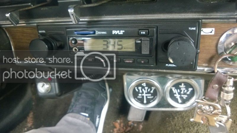

Lets see if this works. Here's my current head in the fairlane. Pyle knobby style. Cost me like $35 but has USB, aux, and even an SD card slot. Has what I need but no ability to configure anything. Is there a way to add some type of processor to it instead of replacing it? Put an eq under the seat or whatever. Has RCA outs for left and right and that's all I have anyhow; left and right rears.

2) for the fairlane I can use raw drivers like that in the rear and tune from there, but I can't use the Clarion as it requires a shaft style radio (unless I mount it under the seat or something). What kind of equipment can I use in conjunction with the cheap Pyle that I currently have that would have the same effect and ability to tune?

Sorry to say, not much can clean up that pyle's signal, If i remember they dont even use 16 bit DAC processors. Most average lower tier head units use 16 bit and the good ones use 24 bit processors.
If you want the cheapest sound processor, this is the ballpark where it starts http://www.amazon.com/JBL-MS-8-Series-Digital-Processor/dp/B003KN2TQ2
AKA processors completely eat up your budget.
