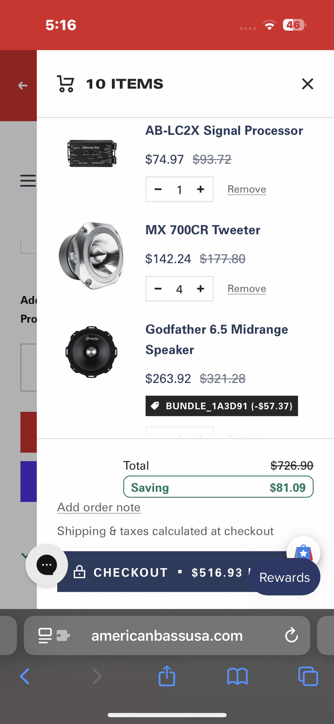

Hey guys, I have a few questions about audio systems. Currently I have 6 6x9’s and a Skar 15 powered by a 2k Skar amp but I have some flaws (the 2extra speakers are spliced into door speaker wires.)
Im looking to go all out and have an absolutely killer system. I was planning on going with American bass for everything.
A list of what I was thinking about buying:
4x Godfather 6.5” midrange speakers
4x 700CR tweeters
Some kinda 4 channel amp
I also need 2 shallow 6x9’s for front door speakers.
Stunt wall for above the rear seats (4 speakers 4 tweeter holes)
My biggest questions are:
Will I need 2 amps to run 10 speakers and 4 tweeters?
Will audio splitters work instead of a 2nd amp?
Signal processor? Will I need one for super clear sound?
Any other suggestions?
Was thinking of downsizing my sub to either dual or quad 8’s.
Overall looking for the loudest clearest sound without spending $1500 to get there.

Thank you for the info. A stunt wall is the only way I could see being able to add 4 speakers and 4 tweeters. And I want loud clear sound. Not necessarily bass.
I’m pretty new to sound systems, so I apologize.
What are active crossovers?
I have an aftermarket head unit from eBay. Sounds just as good as my pioneer did.

I do have a sub so I will have bass. What are other options instead of a stunt wall? Single boxes in all 4 corners? Tweeter locations?
Is impendance hertz?
I’m realizing I have more questions than I thought.
