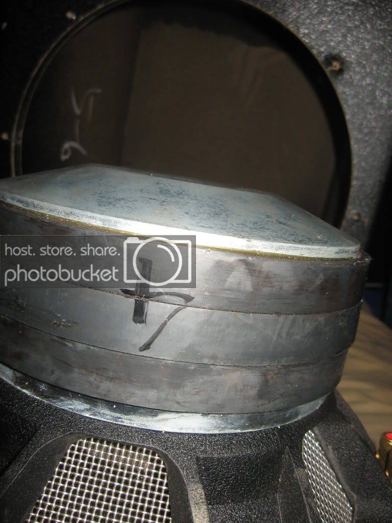

if i bought it could i rebuild it with another cone/basket assembly
ive see ti motors and 12" top assy sell for around $100-$150 for both.
you can rebuild it though if you wish too. only thing hard to come by are 10" spiders with a 3" coil opening

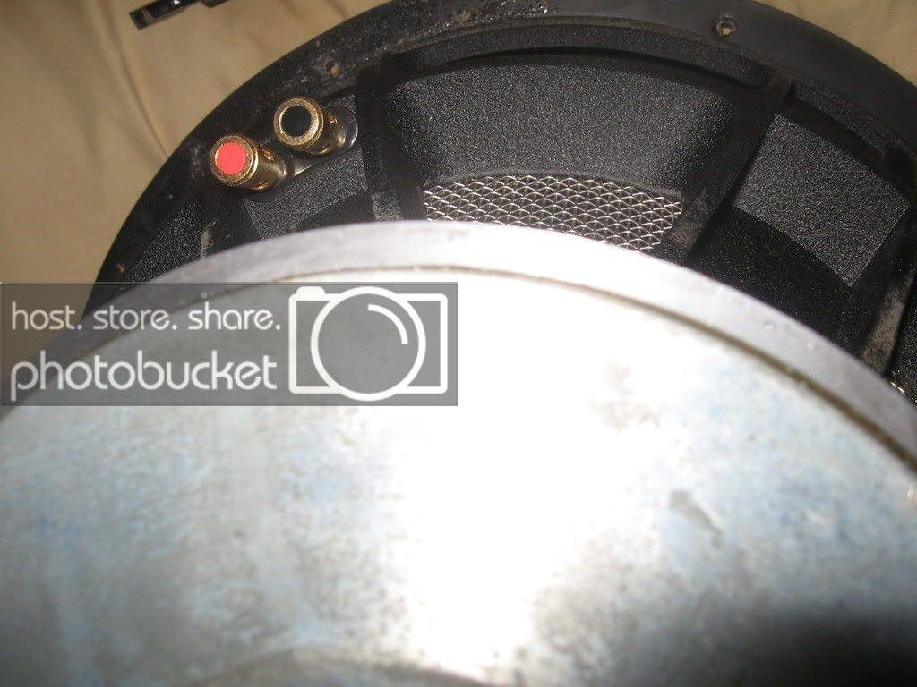

moar pics

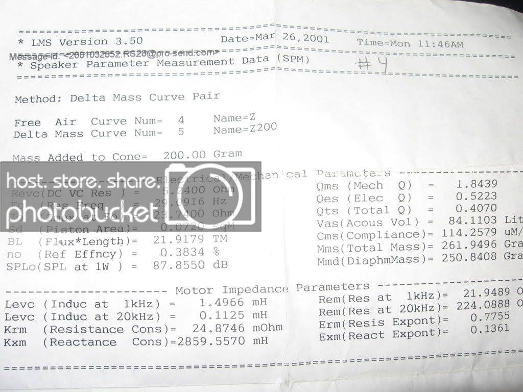

he said he had it tested @ a shop but im not sure, it came with woofer or somthing...
its really old!
it might not be rebuilt...

i was just seeing if you knew what any of that stuff on the paper meant... If it has any clues //content.invisioncic.com/y282845/emoticons/smile.gif.1ebc41e1811405b213edfc4622c41e27.gif
the newer 3hp+ has a larger taper on the bottom of the motor... Is that right?I dont know if i am saying that right
i dont think so... the 3hp+ is the LMT variant and almost ALWAYS has a quad stack of slugs
take a flashlight and look through the grilles on the bottom of the basket, if the coil is flat all the way up, its a normal 3hp
if its looks all weird and the wire changes thicknesses then its an LMT
no. standard 3hp.
NO. newer 3hp is flat on the bottom.
it wont be. standard. if i had to guess- i would say it started life as a ti 15. i would again, GUESS it has a ti coil, spiders, etc. diff. cone. i would offer no more than 175...
