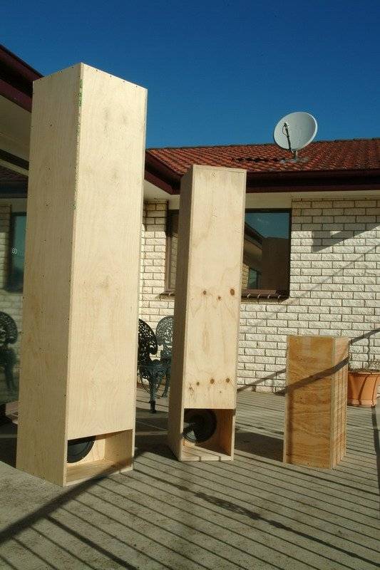

Unless you have a cargo van, from the size of the ones I've seen, good luck getting it inside a vehicle with a useful response...
what!?! what designs have u seen?? one feature of a tapped horn is reduced size
http://www.cowanaudio.com/th.html
Actually a lot like my BIBs...which were 6' tall for 6.5" drivers.
Not sure where the "reduced size" part is //content.invisioncic.com/y282845/emoticons/smile.gif.1ebc41e1811405b213edfc4622c41e27.gif
i knew u were thinking about thoze! yes thoze are huge but there are better designs out there. my uncle showed me one i cant remember where he found it.
At the top of the link quoted -
For a horn to operate properly it must not be acoustically small compared the frequencies (wavelengths) it is to radiate.Conventional horn theory and design formulae are based on this assumption. To meet this requirement the horn needs to be at
least one-half wavelength long at the low frequency cut-off of the horn and the circumference of the mouth must be at least one
wavelength. When used for low frequency reproduction this can make for a very large unwieldy horn that can becomes
impractical to make or move.
