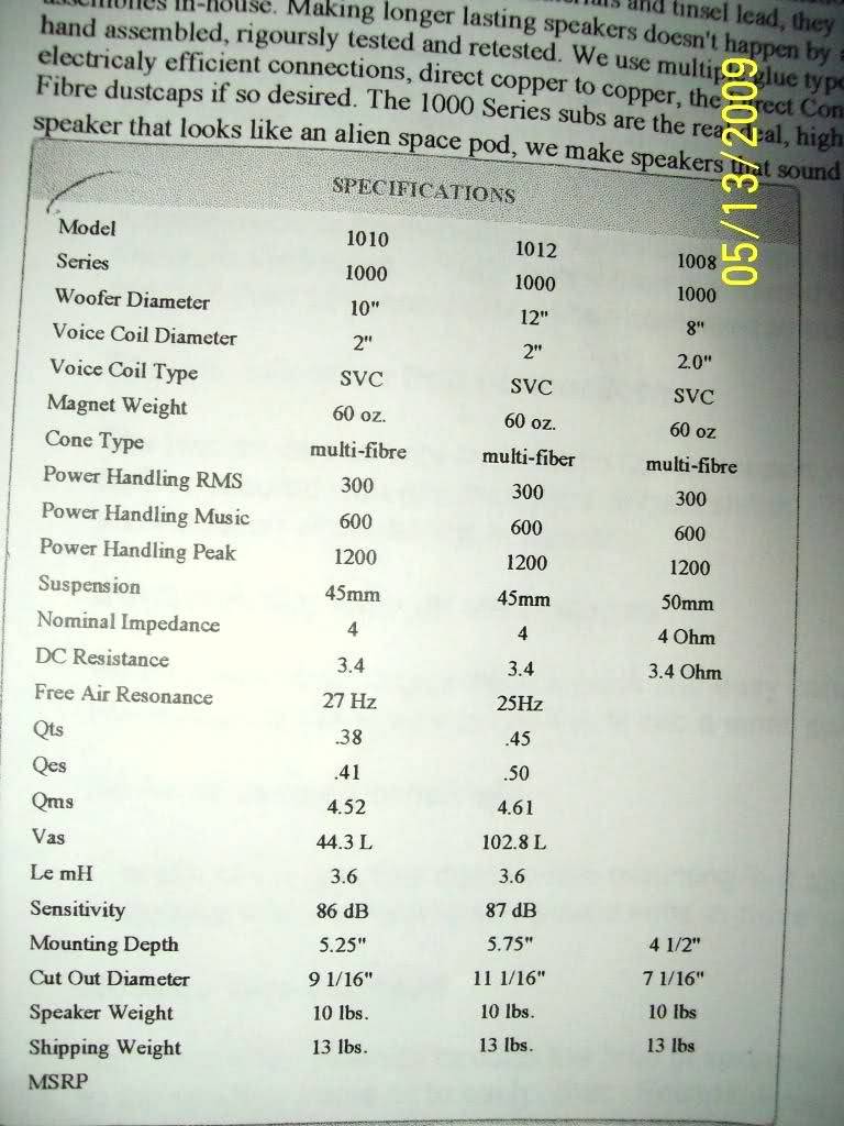

Ok, in the specs, what is suspension= 45mm?
What ?//content.invisioncic.com/y282845/emoticons/confused.gif.e820e0216602db4765798ac39d28caa9.gif
You need to explain yourself better......
Are you asking about the parameters of a certain speaker ?
May just be the Xmech.
It's always nice to see a refresher on specs. //content.invisioncic.com/y282845/emoticons/wink.gif.608e3ea05f1a9f98611af0861652f8fb.gif
A worthless spec without more info, that's what it is. Yes, its xmech. But gee, what if the sub is motor limited? Its misleading when presented like that, most people would assume its xmax.
That is a weird specification for a parameter, it doesn't even say if it Xmech or Exm. What brand of speaker is that ?
