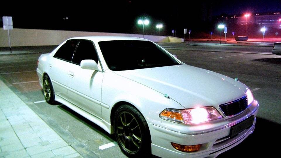

My car is a JZX 100 Toyota Mark 2, similar to the one shown below
