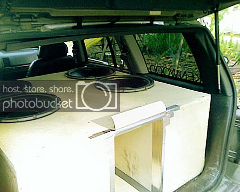

well if you are anything like I am, don't do a wall. I like changing out my system and building enclosures and I had a wall behind the 2nd row seats in my Jeep. I only had it for like, 3 months.
Old enclosure. The port didn't always look like that however.
haha, Mail Pouch
haha, yeah. That was my buddy's, we just used it as a size reference. I've only had Mail Pouch a couple of times and I've since quit tobacco.......................................although the new Skoal Edge is nice.......ANYWAY, back on topic
i never mounted subs facing up. and if i mount them facing the rear they will have to be 30inches back from the doors. not sure if thats too far or not? how hard will they hit facing the roof? it's 3 treo ssx 15's on a jbl 6000
Well considering subs up and ports back is what MOST people/competitors use, it rocks. The closer my port was to my hatch door, the lower the box would play. My quad DVC 15's were probably not even getting 2000 watts and I could still set off car alarms going around the town square. I really wish I could get a real measurement on my amplifier. The way you see it in the picture, my subs played down to 17ish hz full tilt with no problem and the enclosure was tuned to 38 hz. When I had my wall, that all changed. Same port area, same enclosure volume as my original box, just facing forward. Subs up and port back works very well in most SUV's, the older model jeeps are an exception....I think.
