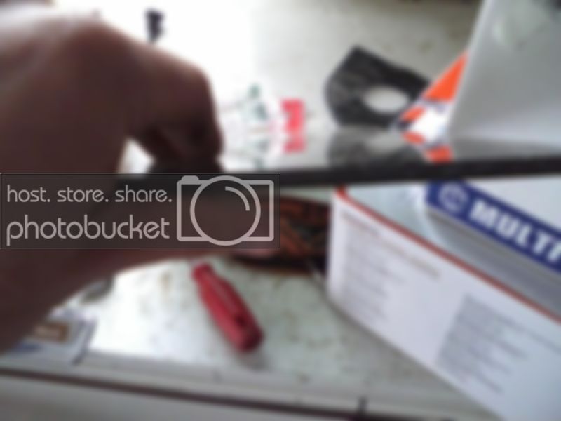

starting materials

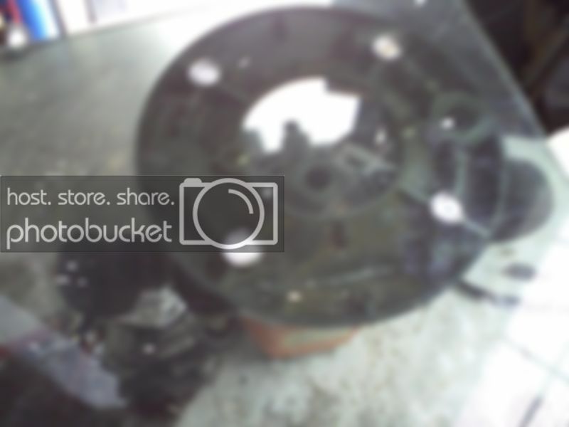

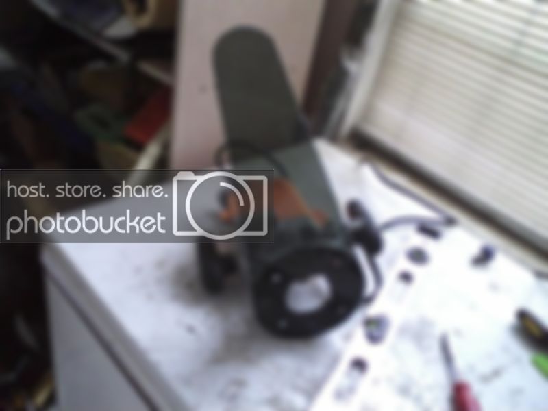

drilled two holes and countersunk the screws
all holes drilled and screws counter sunk

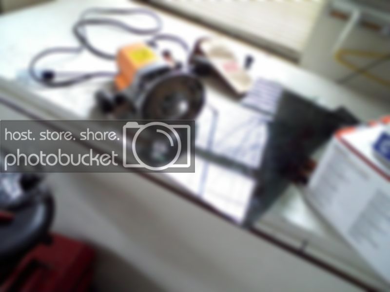

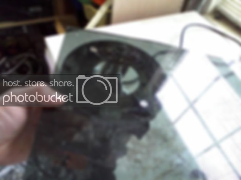

next i traced around the rounters base (inside and outside of the circle) so i could make my lines to cut, i used a jigsaw to cut everything and it went a little smoother than i thought it would, anyways, heres the finished product... i will drill the holes for the circles as i need them
