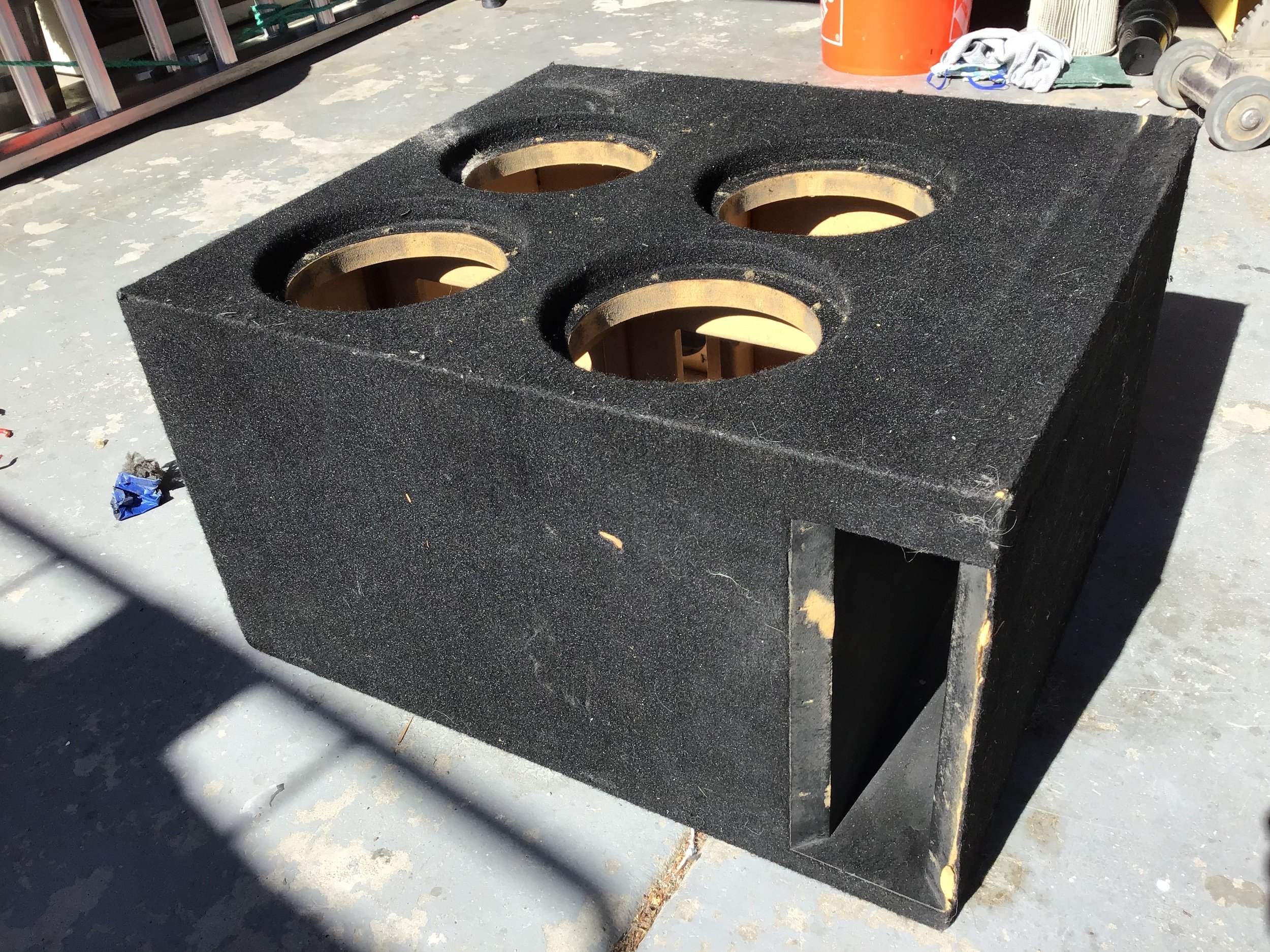

The 6.5 im playing with likes .4 tuned to 36 HZ. That sundown is a little bigger than the one I have, so .5 tuned to 36 HZ sounds about right. 4 of these would be a head turner for sure. I just gave away a used box for 4 6.5s that I acquired through a trade.
Which 6.5’s you playing with?
RDS Audio 6.5. He is making me a 1000 watt 8 with 23 mm of xmax also. Should be done next week. I built a box in trade for some cash and a box with 4 blown subs. 1 of them was just a little tear from pushing too hard, so I just fixed the surround and used it. The 3 blown ones I traded in for 60$ credit towards a new sub.
