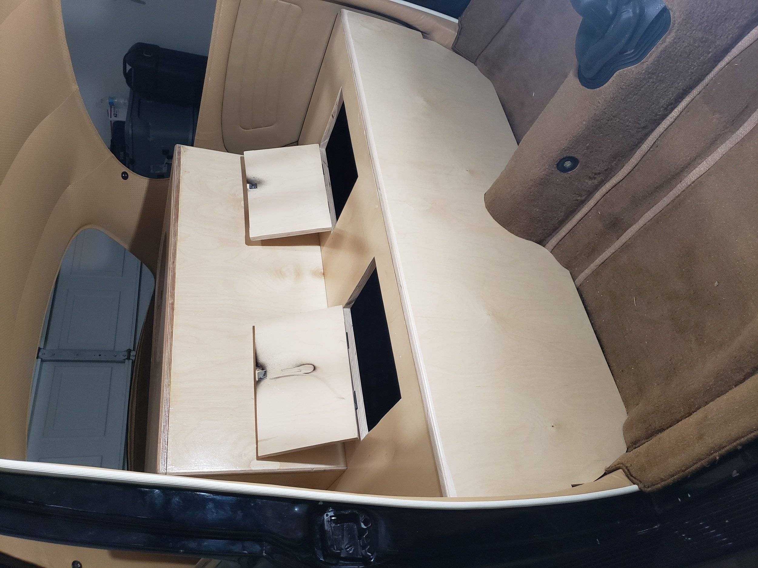

Two AGM's in the trunk? ,
In my Bug. Only two batteries total. Sorry for the sideways pic.

In my Bug. Only two batteries total. Sorry for the sideways pic. View attachment 19303
I have a factory 140 amp Alternator and a xs power D3400 under the hood. I also have a 4 channel on my mids wired to 4 ohm RE Audio 90.4 63w x 4 and, big 3. My car also has all of the electrical accessories. Your saying by adding another agm battery that should keep me out of harms way as it pertains to underpowering the fully bridged amplifier?
