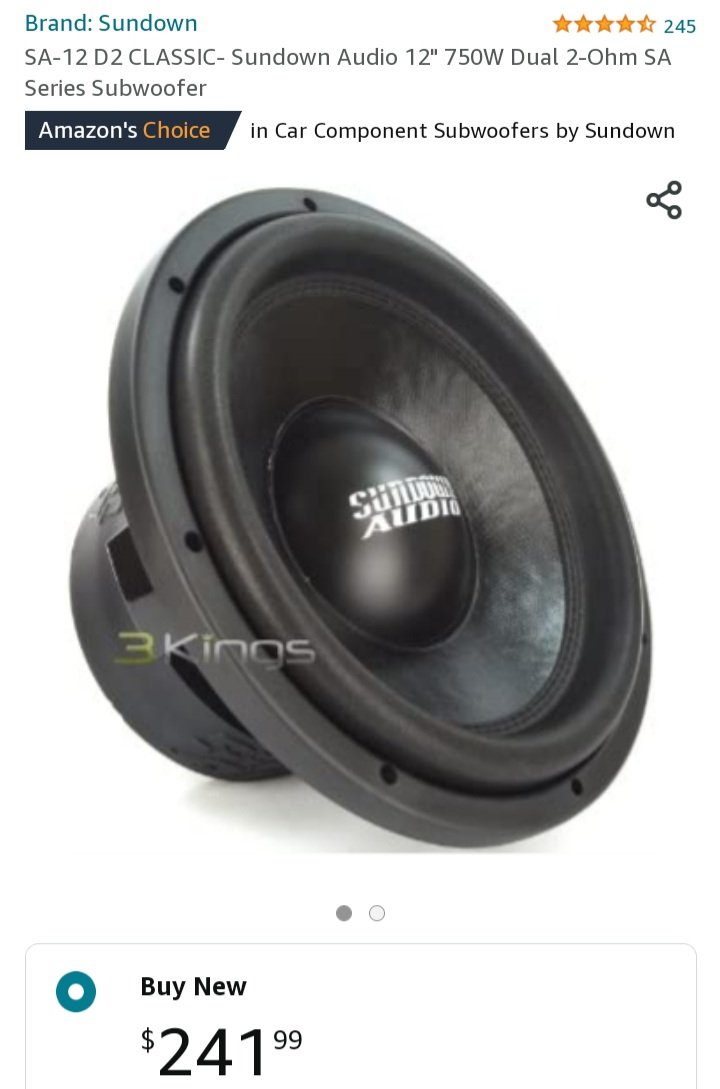

This one might be a better choice for you and save you some money.
There is nothing wrong with running @2ohms mono. I have a pair of 10" DVC2 ohm S.Qubed HDS310s in a 4.0@32htz and had them on a MMats D300HC and it was all I could do to keep my Roof in one piece in my old 99 CRV
Wire it to 1ohm because box rise will likely put it higher anyway.
If it's rated at 1200 at 1&2 wiring lower is going to put out more power overall
Leaning towards the 4 ohm DVC and running at 2 ohms. In the video linked below the amp put out 1151@1 and 1149@2 so almost no difference and I’m thinking it will probably run cleaner at 2.
The older version is rated at 750 watts RMS, with an amp putting out 1150 watts RMS I’d rather go with the updated version rated at 1000 watts RMS for $80 more (since I’m only running 1 sub). Appreciate the suggestion though.
Their amps come with a certified power birthsheet so I’ll know more when that is delivered.
