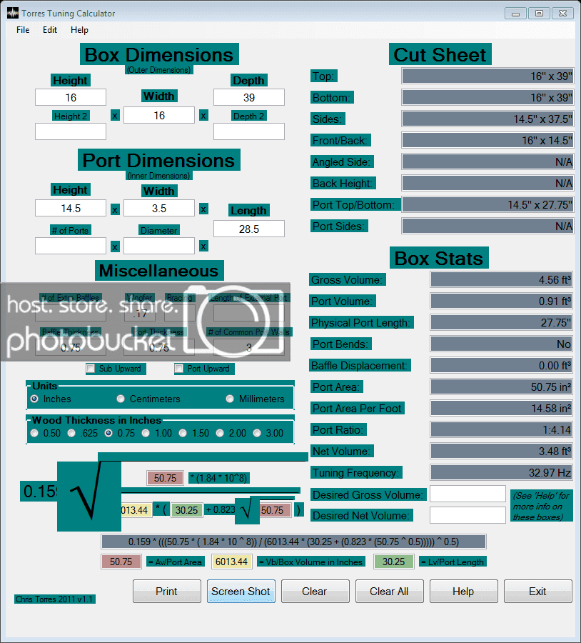

Ok so its my first time building/designing a ported box. Iv'e been researching alot the past couple days and learned a good bit of info. I used the torres box calculator, WinISD, Google Sketchup and also some pen and paper calculations and i think ive almost got it down so heres some specs form torres.
p><p>I
Build A)
Both of the boxes are 40x16x16 with 14.5x3 port openings and 28[/IMG]
Vehicle : F150
Location in the vehicle: Center console
Space available (Length x Width x Height): 16x16x40
Subwoofer make and model: Sundown sa 15
Subwoofer Size:15
Number of Subwoofers:1
Type of Port (Kerfed, Slot, Aero, etc.): Slot ported
What type of music do you like?: Rap
Is your goal SPL or Everyday Music?:Balanced but leaning toward spl
Tuning Freq (Hz): 32-33
Volume : 3.2
Questions:
Basically i need to to know if im on the right track with my build. All help is greatly appreciated any tips on what i need to do or modify. Like i said this is my first time using any of these programs and i don't know the tips or tricks to them.
thanks
Bottom sketch up will work best, but move the sub cut out all the way forward so it's not near the port mouth. You may have to have port rear firing if you don't want the sub right below your face and arm. I'd bump up the port area and port per just a little for the SA. I'd also shoot for 3.5 net cubes. You'll also need to add 3 to your common walls, that will change net volume and tuning some. Adjust accordingly.

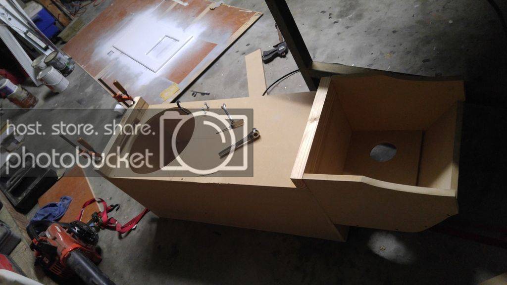

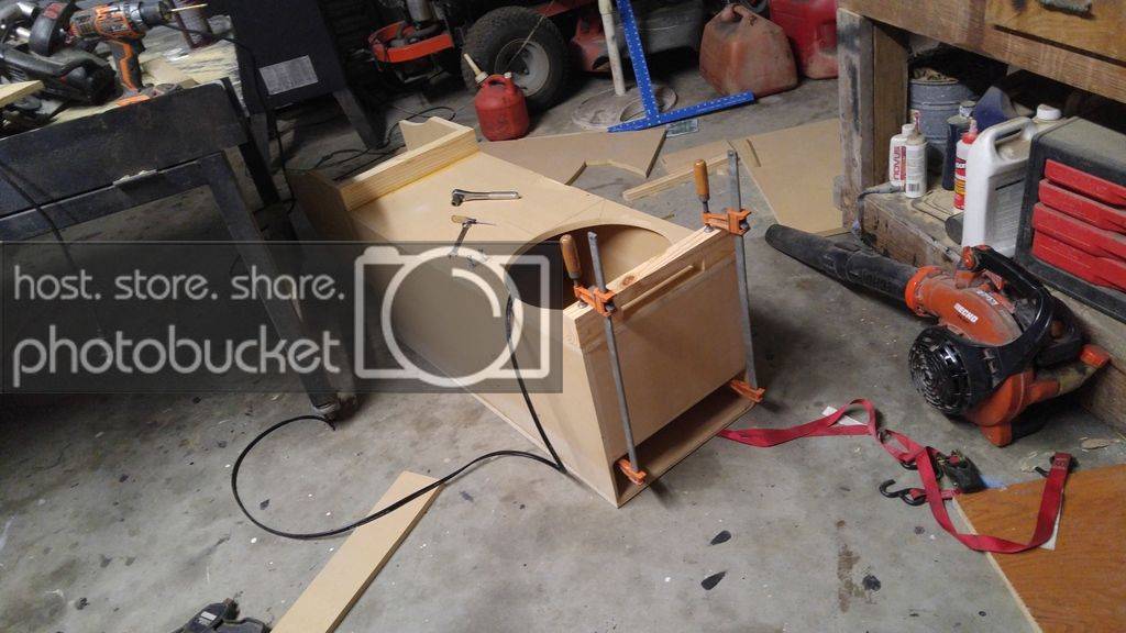

The sub box is actually really close to being done. As u was very limited on space I could only go 16" high. But thanks for the design is plan anyway. It's almost done, tomorrow I'll be painted a little bit for the top design of the box, putting in the cup holders, and carpeting the rest of it. So hopefully it should be done by tomorrow. And hopefully be able to install by Saturday. The sub comes in tomorrow super excited. Here's some progress pics.
Thanks again for all the input and tips.
