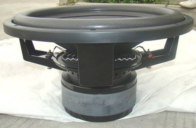

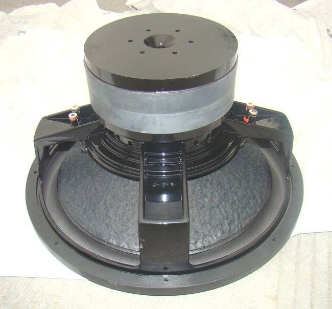

These will be on their way to me soon for testing... no ETA just yet, though //content.invisioncic.com/y282845/emoticons/smile.gif.1ebc41e1811405b213edfc4622c41e27.gif
SA-10 :
FS : 31.6 Hz
Qts : 0.45
Qes : 0.49
Qms : 5.64
VAS : 21.9 L
Mms : 187.4 g
SA-15 :
FS : 30.9 Hz
Qts : 0.60
Qes : 0.66
Qms : 6.12
VAS : 92.7 L
Mms : 308.4 g
I can't wait to get to testing //content.invisioncic.com/y282845/emoticons/smile.gif.1ebc41e1811405b213edfc4622c41e27.gif
If you are wondering why the Fs isn't like 20 Hz on the 15 inch... that is because we stiffened it up a bit to keep box size down.
Suggest Box Specs :
SA-15 :
Sealed @ 2.5 cubes (Qtc = 0.888) - F3 of 42 Hz
Ported @ 3.0 cubes tuned to 35 Hz - F3 of 30 Hz
SA-10 :
Sealed @ 0.75 cubes (Qtc = 0.649) - F3 of 50 Hz
Ported @ 1.25 cubes tuned to 35 Hz - F3 of 29 Hz
