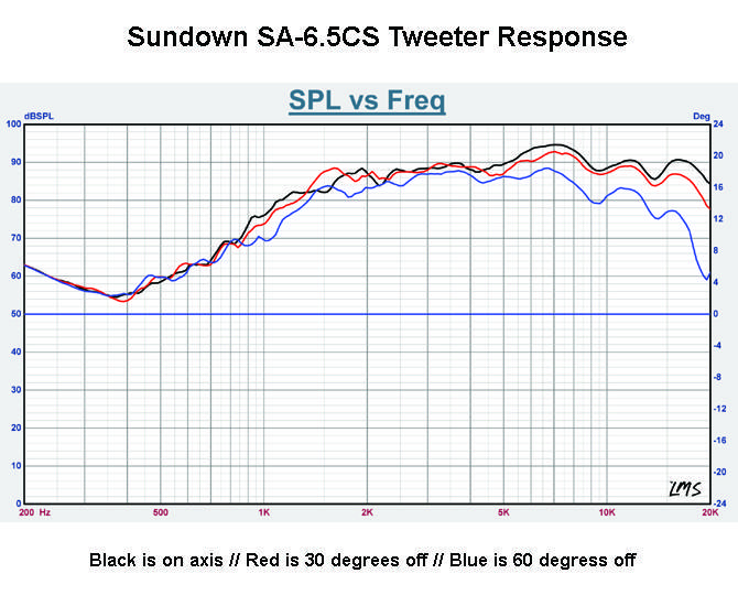

Here is the tweeter plot with off axis included.

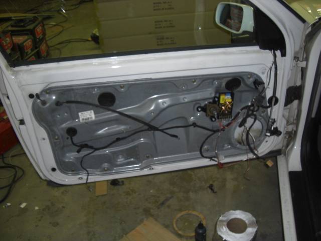

* The door is already very solid so that is a plus for sure! Crossover is installed on the door itself as well.

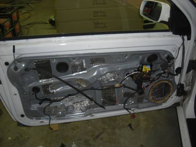

* Added some Audio-Technix dampener on all the large flat spots and also behind the mid. Also installed the wooden adapter ring for the mid to the door.

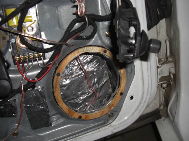

* Some dampener directly behind the mid.

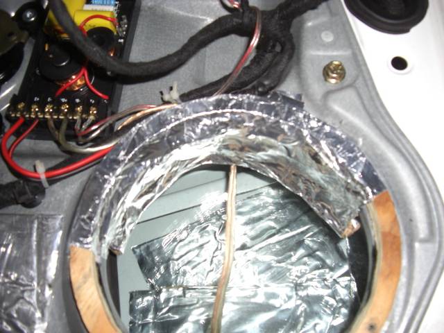

* Made a raid guard out of a few pieces of dampener and some aluminum tape -- this will keep large amount of direct water off the mid. Ambient moisture is really not a concern for the treated paper cone but we don't want water dumping down on it.

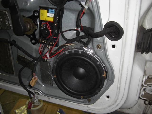

* Mid fully installed.
