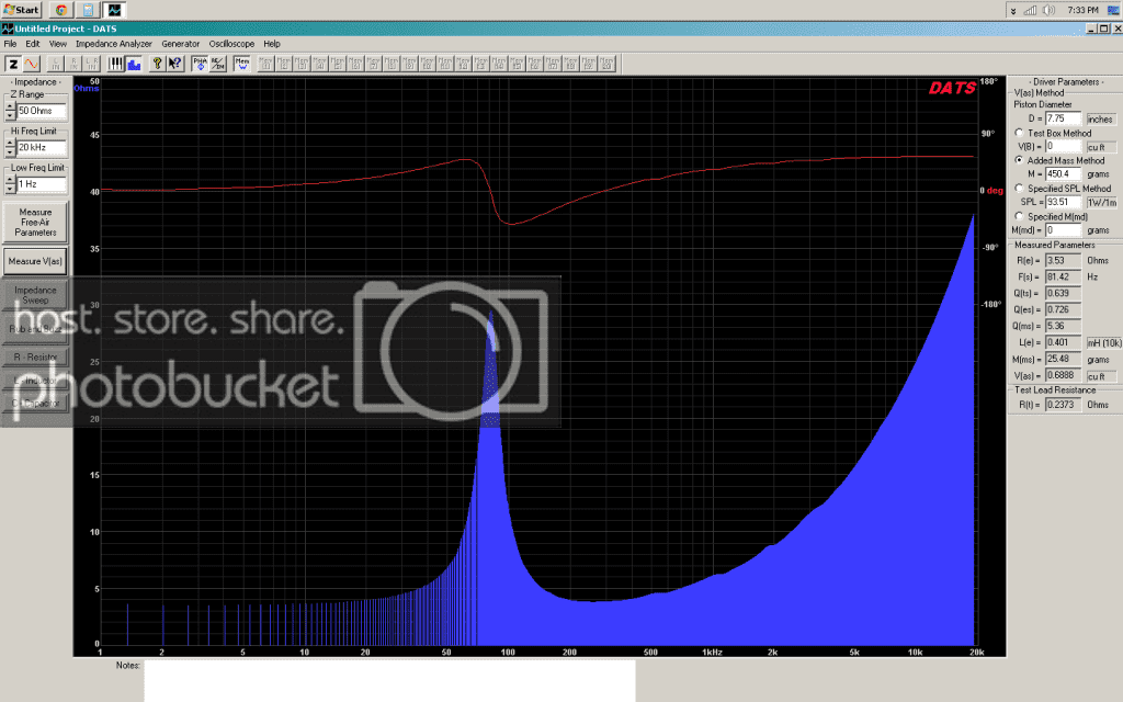

That's an interesting observation. I've not found TS parameters published for these drivers and have been wondering about them since I got them. But since then, I've bought a DATS and I think I'll pull one tomorrow and see what it reports, because I've not experienced the problems you mentioned.

That's pretty close. DATS read 93.51dB on a "broken in" Neo Pro 8 from my door. And I would agree with Jacob in making sure they work well at and just below 80 Hz. Fs on this driver is 81.42 so it's pretty much where it needs to be for a car audio door speaker. So they may not work flying in a cabinet above the dance floor in a nightclub but then, they're only "PA" speakers in that they mimic the build style of PA speakers. In the end, they're car audio drivers and so far, I've had no issues with mine dumping 300 watts each on them, which is double rated power.
