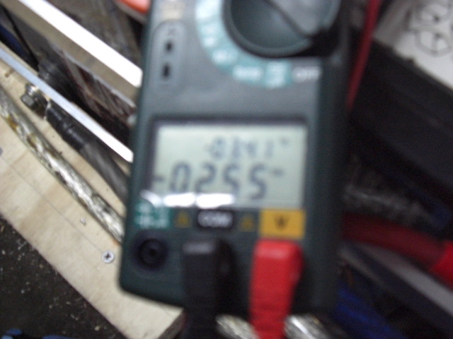

During the 150.0 dB run the 1500D clamped 2640 watts. I am running the amp at 17.9 volts and 1/2 ohm nominal.
My meter measures about 5-6 seconds into the burp and is a True Power meter.
It says "2.55 kw" in the above picture in case you can't tell due to the blurry-ness. This was a 149.9dB run.

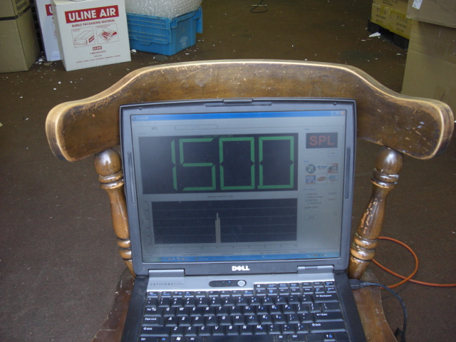

So... two Z15s with just a hair over rated power hitting 150.0 dB @ 50 Hz //content.invisioncic.com/y282845/emoticons/smile.gif.1ebc41e1811405b213edfc4622c41e27.gif Not bad at all.

WOW over 2600 watts from an 1500 watt amp!

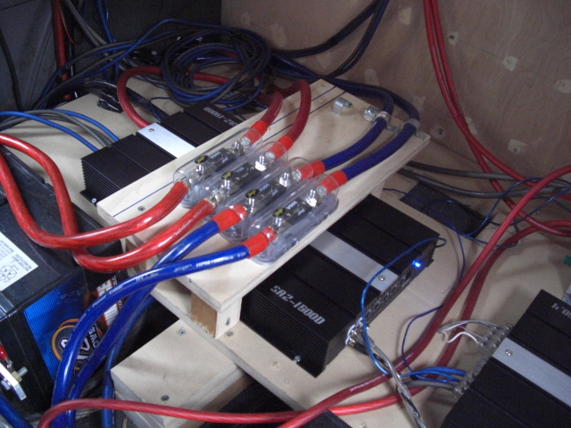

Derrick824, why did the amp go into protect?
I only keep one amp in my truck daily & had just dropped the second amp in that afternoon. I assumed it's settings were still set correctly from when I had both in there at SBN but they weren't.

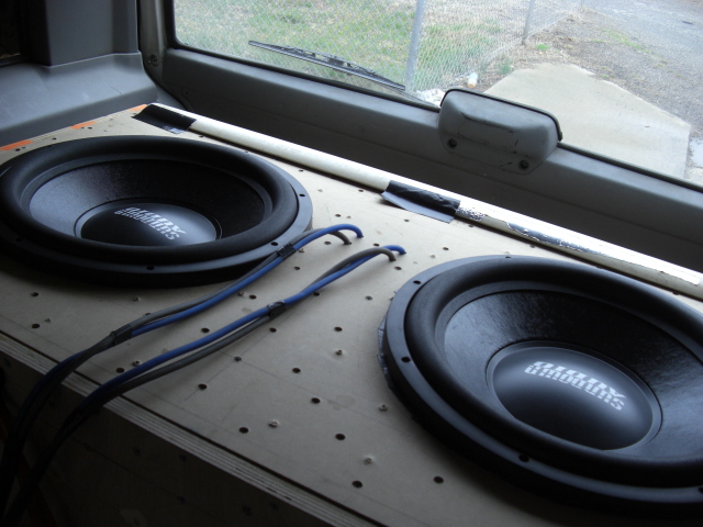

Mine ? It is multiple layers and the screws are there to keep the layers together. Also, the screws around the edges go through both baffles and hold in my corner pieces.
That's alotta screwing! //content.invisioncic.com/y282845/emoticons/tongue.gif.6130eb82179565f6db8d26d6001dcd24.gif Its hard to tell exactly whats going on there with all of them, some even seem to be almost poking thru from the back side... but Im gonna guess here and say you didn't quite so many. //content.invisioncic.com/y282845/emoticons/wink.gif.608e3ea05f1a9f98611af0861652f8fb.gif

There are some little holes in the front where I screw down adapter plates to test 12s in this box too - those holes only enter the first layer.
