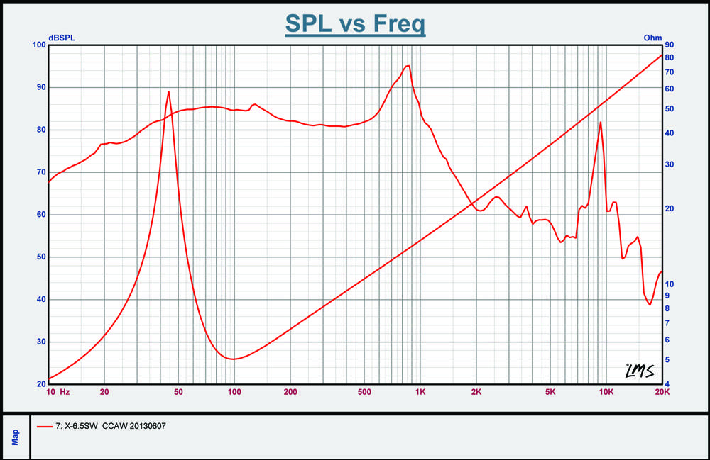

Got the response graph in; could be very useful as a mid-bass as well //content.invisioncic.com/y282845/emoticons/smile.gif.1ebc41e1811405b213edfc4622c41e27.gif

That impedance profile doesn't really jive with the .44mH figure. Does this sample have the copper treatment?

It's designed as a dedicated sub-woofer ; I'll post the full response of it up when we finalize the coil, though, as it should be useful as a mid-bass as well.
