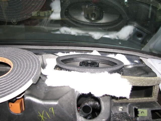

these beasts are 8 ohm SVC. i put these in the rear deck of my dad's 90 deville. ran off an Alpine HU, they have a lot more punch than the factory speakers did (obviously). and they cover midbass being played full range (natural roll-off above 200Hz due to inductance). it bugs me that i can localize them, but my pop's is thrilled to have full range music regardless of it's location. the factory dash locations were used with aftermarket 4x6 coax (with a HPF).
those rear woofers have a 2" thick mount, but mate up with the rear deck perfectly and you can't tell.
can you do what you want? sure.
does it sound good? i don't think so. my pop's wants a factory appearance, which limited me to what we have now...
i drove his car this weekend for a trip, about 3 hours each way. it's annoying having the front/rear split around 200Hz. i want to put an amp in the car to run the rear woofers as subs, then install midbass up front and replace the 4x6 with some plate 4x6 comps. that would be the correct method.
