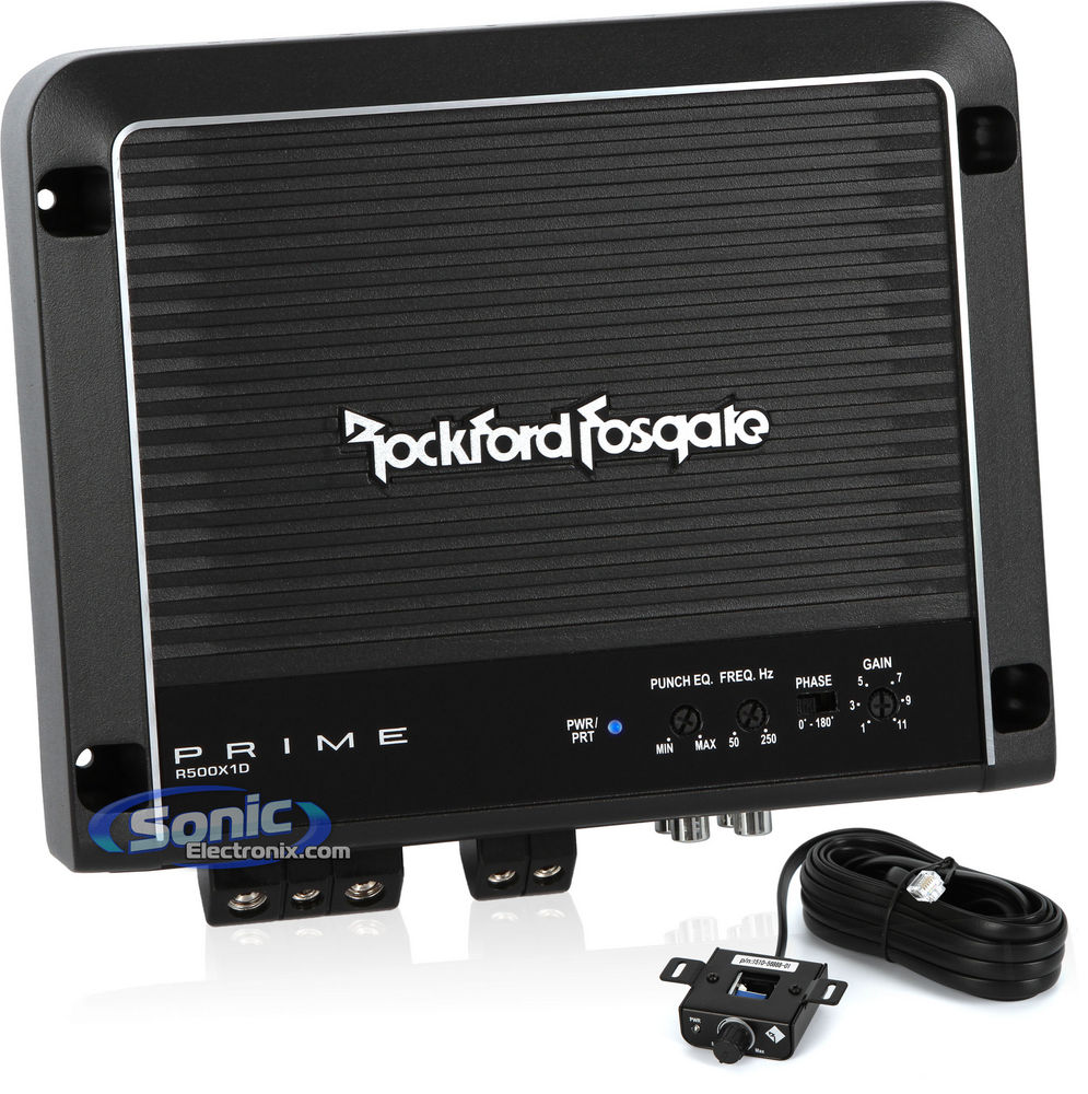

That said, should I be worrying about a subsonic filter? The amplifier I'm planning to get does not have one. I want to get a Rockford Fosgate R500x1D. Amazon Link

Why is it rated 500 @ 2 and also 500 @ 1? Im not very well rounded about amplifiers but isn't the rating @ 1 ohm supposed to be higher?
That RF has a filter.
Not a Subsonic filter. Has a low pass filter
Probably asking on the wrong forum unless you want misinformation.
Short answer I would still use the SS filter if you are not 100% sure what notes all your music plays... Don't want to be surprised by 18hz out of nowhere and throw the coil out of the gap.
