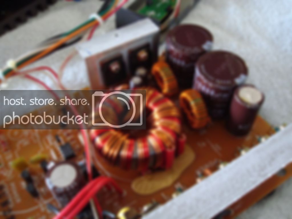

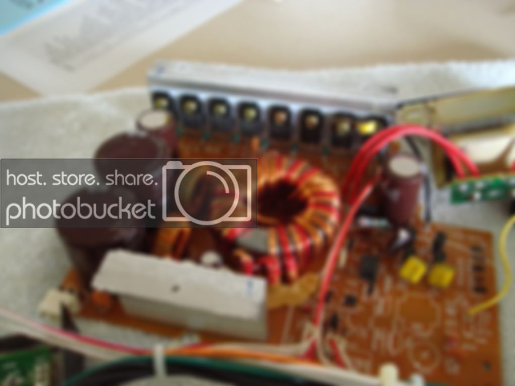

Seriously? wow!!! i have yet to hear them properly hooked up , only on seleniums with 8 gauge power cable , they made the 8 gauge get seriously hot! i've only tested them , have yet to use them in the ride.
Seriously? wow!!! i have yet to hear them properly hooked up ' date=' only on seleniums with 8 gauge power cable , they made the 8 gauge get seriously hot! i've only tested them , have yet to use them in the ride.[/quote']Yeah, they'll surprise you. Although, I just noticed that you have the 5540F and I had the 5540. Basically yours has HP/LP filters and mine was just a gain block. I'm not sure which version came out first but they do have different power supplies. I stand by my advice though.
This is mine.
yeah , they both are similar but still different , the board in the 5540 mounts upside down and definetly has a different power supply from the 5540f. I'm not sure which produces more power or if there is a difference , i just picked the 5540F for the mids and highs because the gains are more accessible. I'm gonna be running active which will require a little hard core tuning at first so i want them easily reached.
