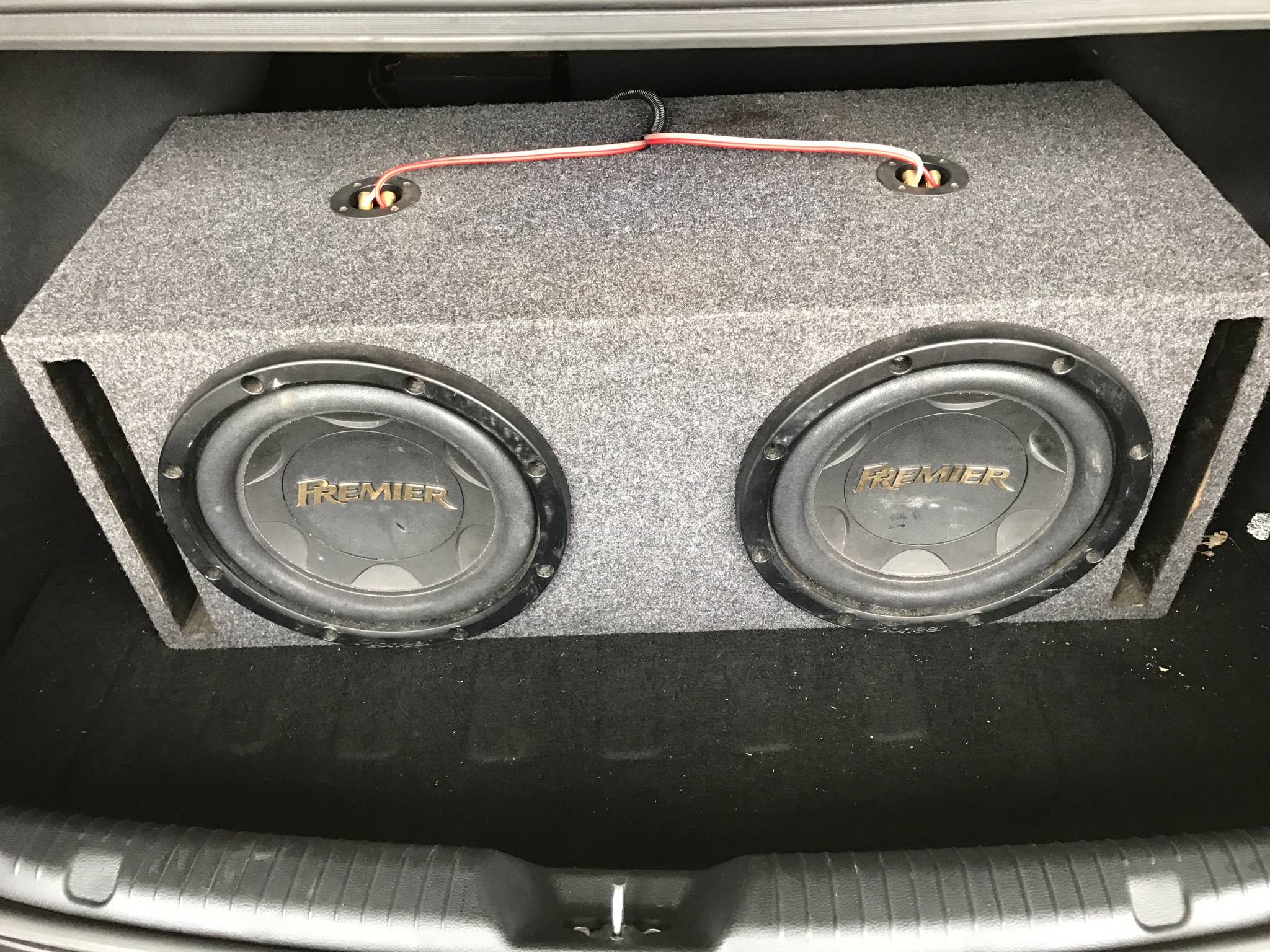

So I got a set of used subs and amp from my coworker a couple months ago, they sound great!
But lately when the volume is too high, the sub kicks out and there is practically no bass. I have a 15 Kia Forte and my original head unit that uses a line in converter. I know it's a bad setup but I didn't want to get a new stereo.
So I was wondering if it's the amp that's going bad? It runs really hot but I know that's typical for amps. Maybe it's the power wire cause the guy who installed it used 8 gauge wire. I told him to use 4 but he insisted they wouldn't draw that much power for 4 gauge.
If anyone knows relatively what the issue is, that would be great. I'm assuming it's not the sub because they sound really good when they are on.

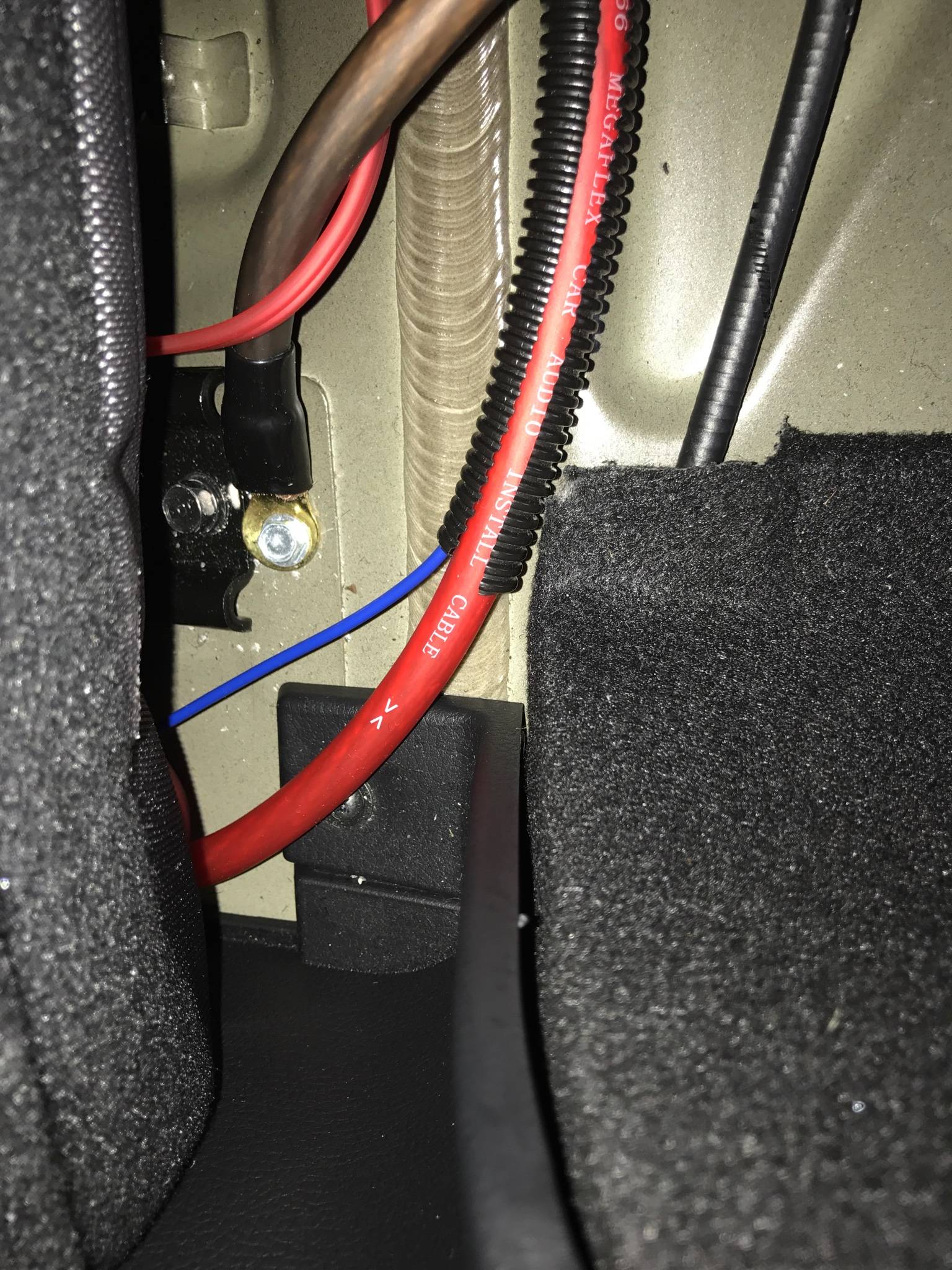

Ok so I just looked at my ground wire and it is touching a little bit of painted metal
Should I move the ground then?
Yes. Should be a wife coming from the negative on the amp, the other end should be bolted to some exposed bare metal in the car
Try a voltmeter. Put it on ohms, connect one lead on the voltmeter to the negative at the amp and the other to the ground bolt. Make sure everything is off first

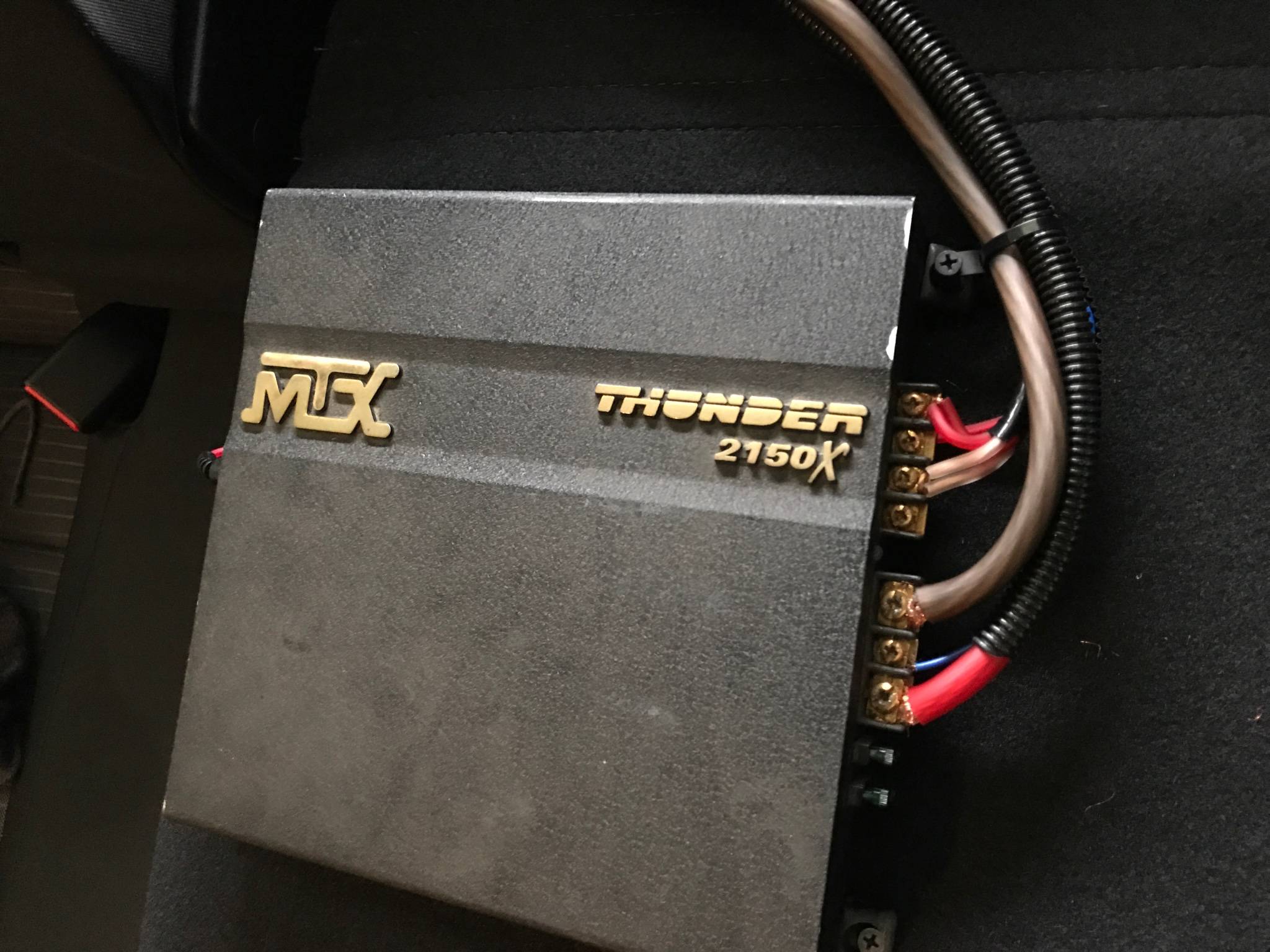

Im curious, what impedance the amp is seeing? Do you know what final load you have from those subs? I'm willing to bet it's too low and the amp is going into protection and cutting off, then wen it cools kicks back on. I'd check that first.
So are you saying that the amp is too weak? I'm sorry but I have no idea what final load means, but the explanation you give does make sense
Not necessarily, its about matching everything up. You need to do some research. Find out what ohms are, a load, 4 ohms, 2 ohms, etc.
Look at the subwoofers(take them out) and see if they are dual 4 ohm, or dual 2. Go to harbor freight and get a cheap multi meter and meter them. Find out if your amp is stable to 4 ohms or 2 when bridged. The Try a tool like wooferwiringwizard to help you wire it up correctly. If your amp cant handle the load the subwoofers are wired at, you need to change it, or you will burn up the amp eventually.
Yeah, that amp can't handle anything below 4 ohm bridge...
75 watts x 2 into a 4 Ohm load with less than .05% Thd+N
150 watts x 2 into a 2 Ohm load with less than 0.1% Thd+N
300 watts x 1 into a 4 Ohm load with less than 0.1% Thd+N
I'm sure it's seeing a 2 or 1 ohm bridge!!

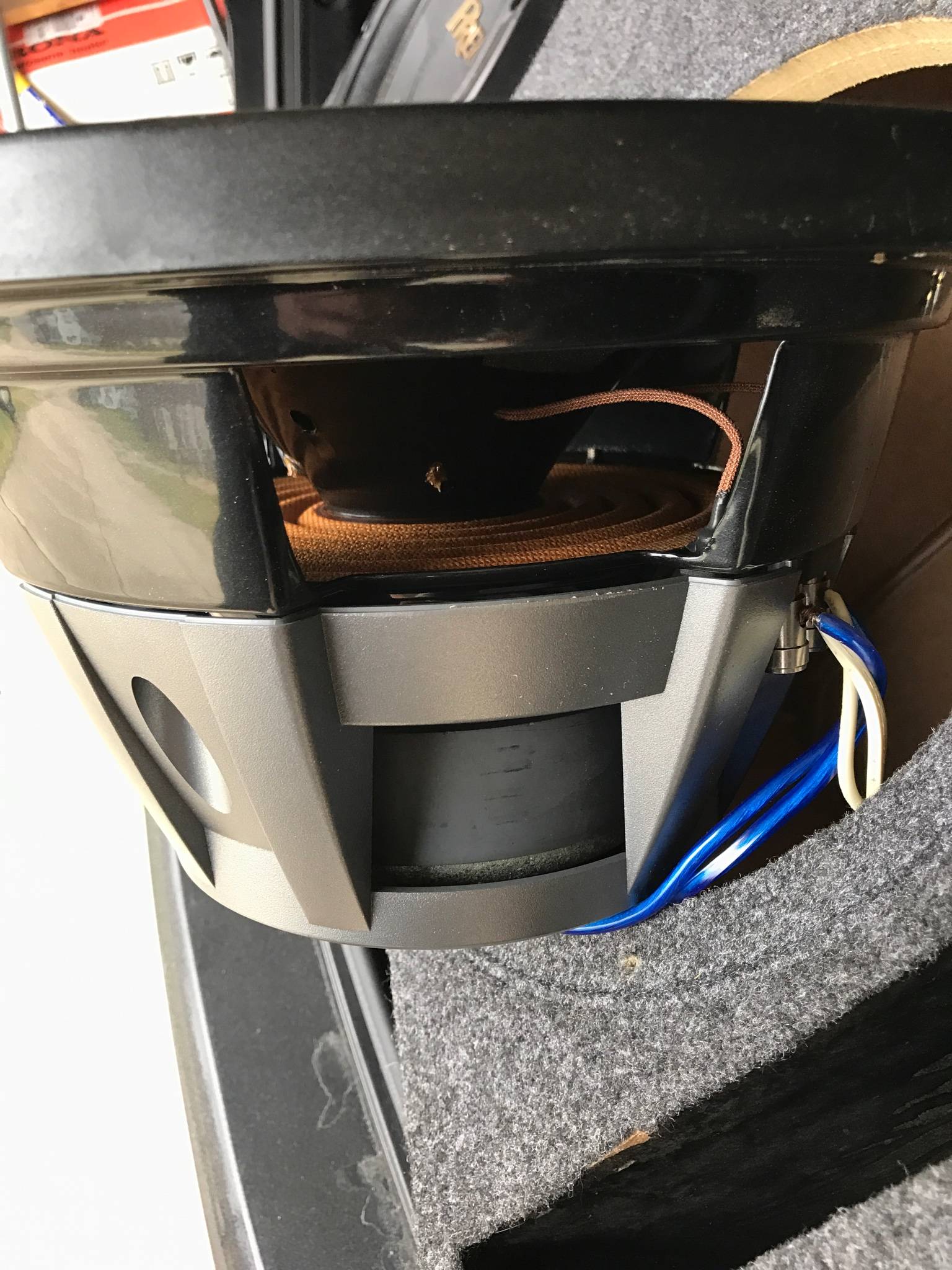

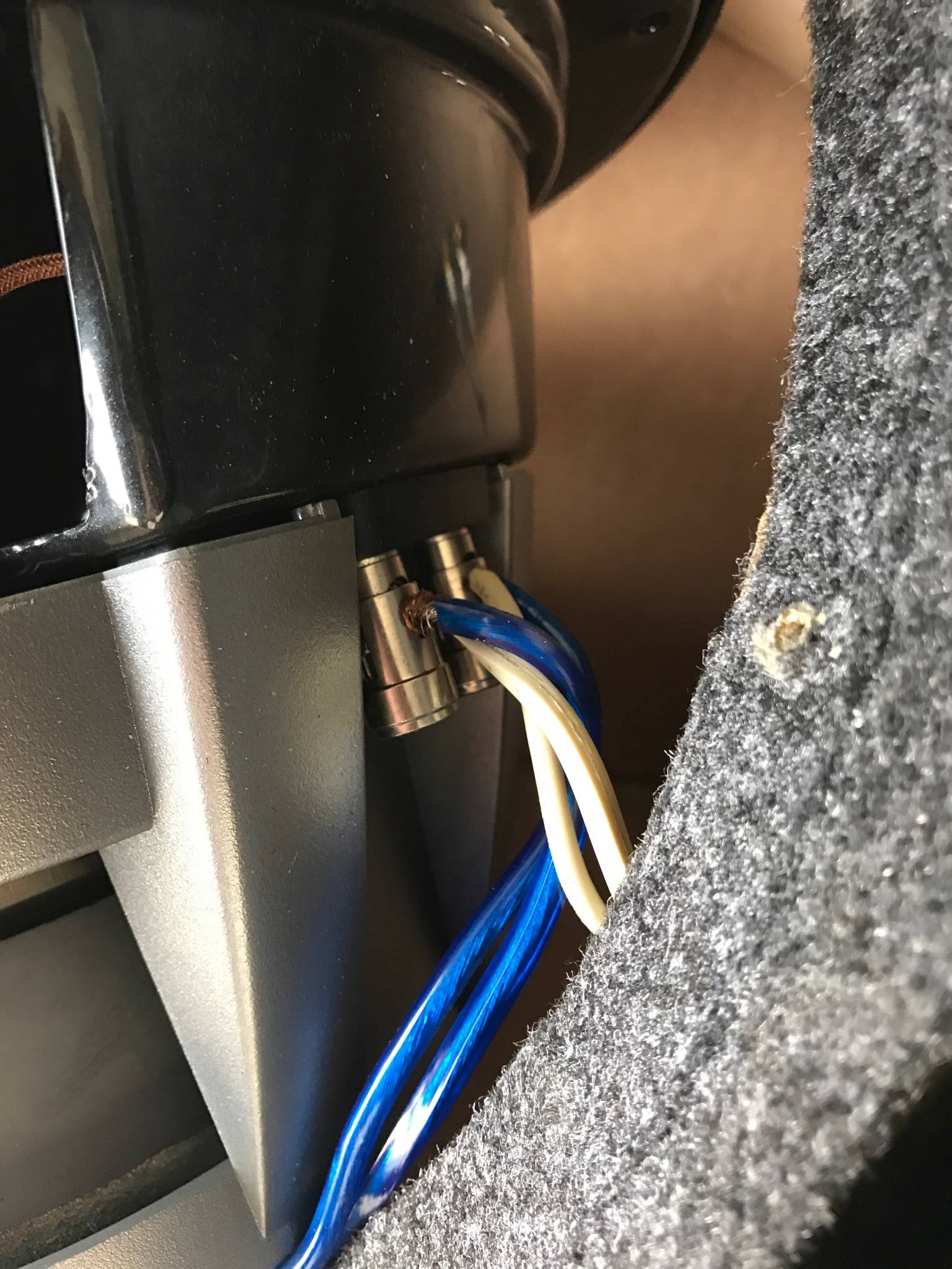

Take out 1 of them subs and take a picture of each of the terminals and post it up here.
---------- Post added at 07:19 PM ---------- Previous post was at 07:18 PM ----------
Sorry not 100% sure if that's what you meant
