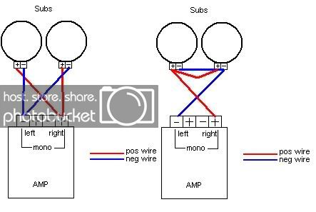

My current wiring configuration is on the left, possible on the right. Would the one on the right be lower ohms then the one on the left. Subs are svc 4ohms.
The drawing on the left looks to be wired in parallel and the one on the right in series. So if you have 2 4ohm subs wired in parallel they should be running at 2 ohms.
And is the diagram of your amp accurate? I've never seen a mono amp that you connect the far right negative and far right negative. From what I've seen it's usually connecting the first 2 positive and negative inputs (from left to right).
it would be the + from the right channel and the - from the left channel....he is correct if this is a 2 channel amp.
yep, you're right.
And yeah they both are parallel. Didn't look at the right diagram close enough :/
