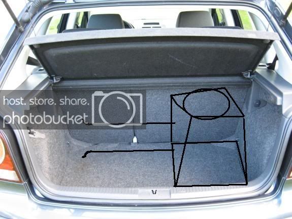

sub up port side like this
sjobas
i have a small hatch, and im going to test a single 10, and to fit a long external port it must go to a side.. how will this work you think?
(i know im good in paint //content.invisioncic.com/y282845/emoticons/biggrin.gif.d71a5d36fcbab170f2364c9f2e3946cb.gif )
port back is usually the way to go in hatch. how about doing a 90 in the middle of that port to keep it rear firing? idk ivenever seen it done but it may work. try both
Sub up port to the side always worked good in my talon, no real noticable difference to the ear. My next box for my new hatch is going to have port facing the side because is rattles too much firing back.
remove the cover and do port up sub up and you will be happy you did..
yeah i will remove the cover, but the problem is that i must have a external port when my box will be only 1,23cuft, so the port will be looong //content.invisioncic.com/y282845/emoticons/smile.gif.1ebc41e1811405b213edfc4622c41e27.gif
oterwise i would have both firing both back, but thats impossible now =/
