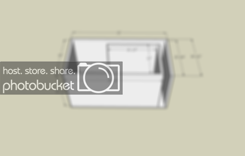

This is to exactly the specs you gave, I didn't verify the tuning or anything:
Just did the calculations on that box, since I'm bored, and I wouldn't build that....
not enough port area for the size of the box, plus whoever did the calculation's math was a tad off, which would put the tuning lower than your 28hz.
