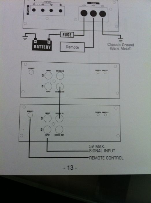

Looking at the wiring diagrams included in the manual, I have a couple questions:
1) Im going to assume the top amp in each drawing is the "master" amp and the bottom amp is the "slave"
2) "Master" amp is the + on the speaker, "slave" amp is the negative.
Picture 1 shows the speaker wiring:
The only thing i noticed was that I hooked my speaker up to the last terminal instead of the 3rd, would that matter?
Picture 2 shows the RCA wiring:
This is what confused me. Wouldn't the "Master" amp have the signal input and remote? I hooked up my "master" amp (going to the + on the speaker) with the signal input, but I would not give enough power unless i had it plugged into bridge out?
Could my wiring have toasted an amp? When i check the ohm load at the speaker terminals a couple days before my issue, it read right around 2 ohms...
