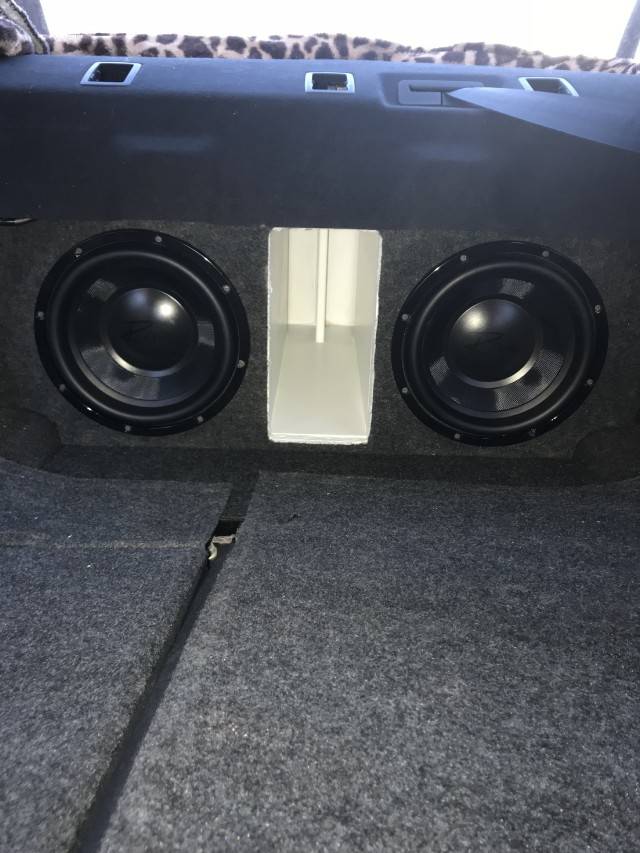

yup I eventually ended up foward firing, I was thinking about building a couple steel rod braces inside trunk, im happy with these results tho. **port is just primer atm***
